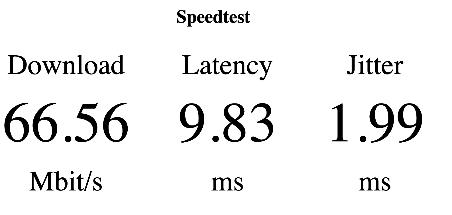

Sluggish jump forward
Here's the latest.
