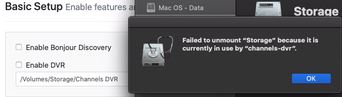

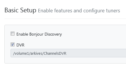

I would think by unckecking the DVR checkbox while you run the disk utilities?
Screenshot_2020-12-23 Channels DVR

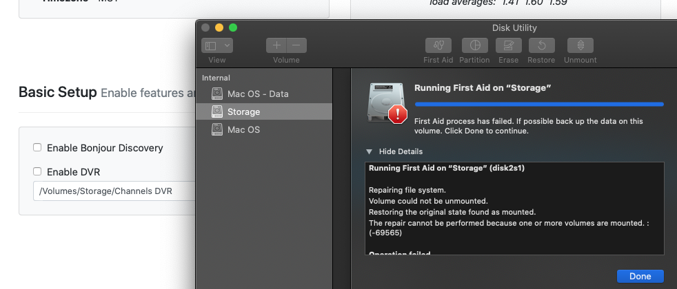

No luck in unmounting. Even if we disregard that the drive is not the issue, I am still wondering how to stop Channels so that I can run Disk Utilities on it..

You use the installer to turn it off and on.

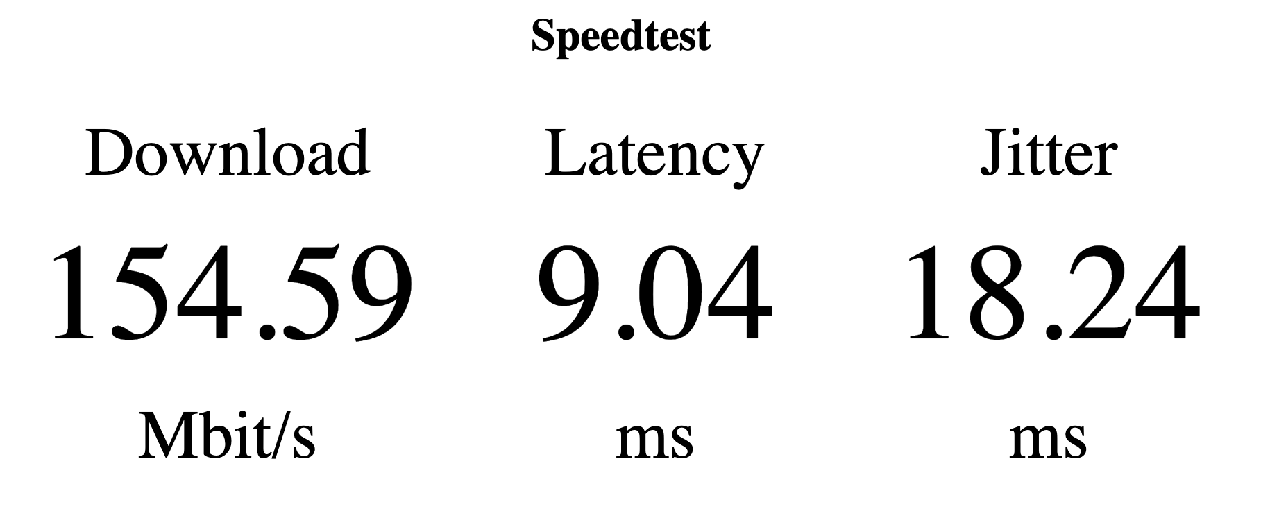

Have you run a network speed test between your iMac and Apple TV?
https://getchannels.com/docs/getting-started/faqs/channels-apps/#how-can-i-test-the-network-speed-at-my-tv
So from Safari or another browser on your iMac, http://x.x.x.x:57000/speedtest using the IP that you found for your Apple TV

Here's what I got...

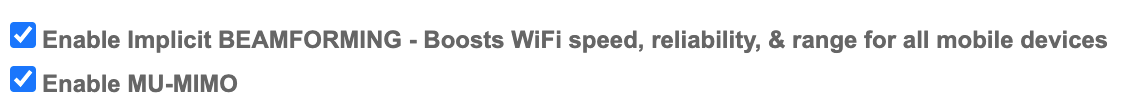

I just ticked these two first settings and the router rebooted. FF seems to be working better. Not sure if these two setting did anything or perhaps the router rebooting might have actually helped.

I'm betting your speedtest numbers look better since you enabled beamforming.
My iPadPro 20 feet away from my router using beamforming gets 350.22 Mbit/s, 3.28 ms and 2.16 ms.
3 feet from the router it goes to 500 Mbit/s, 2.28 ms and 1.00 ms.
