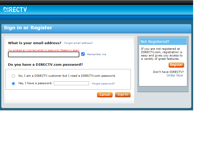

This is what your dvr is seeing:
Are you able to login and watch on sciencechannel.com
Yes, I am able to log in and watch live TV.
Do you see in the logs which email and password were used to try to log in? If so, you can let me know in private.
Should be the same as all other channels with my DirecTV credentials.

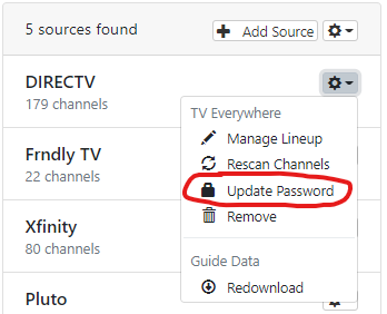

Problem fixed!
The screenshot that you posted, @tmm1, gave me the idea to update my password in my DirecTV source:
cdvr_update_password
I simply put my password again (the same that I use to log in on the websites to authenticate with my DirecTV credentials).
I rescanned all the channels after that and now everything is back.
I don't know why this needed to be done but that fixed my problem.
I am posting this in case this helps somebody else (at least @CScott).
