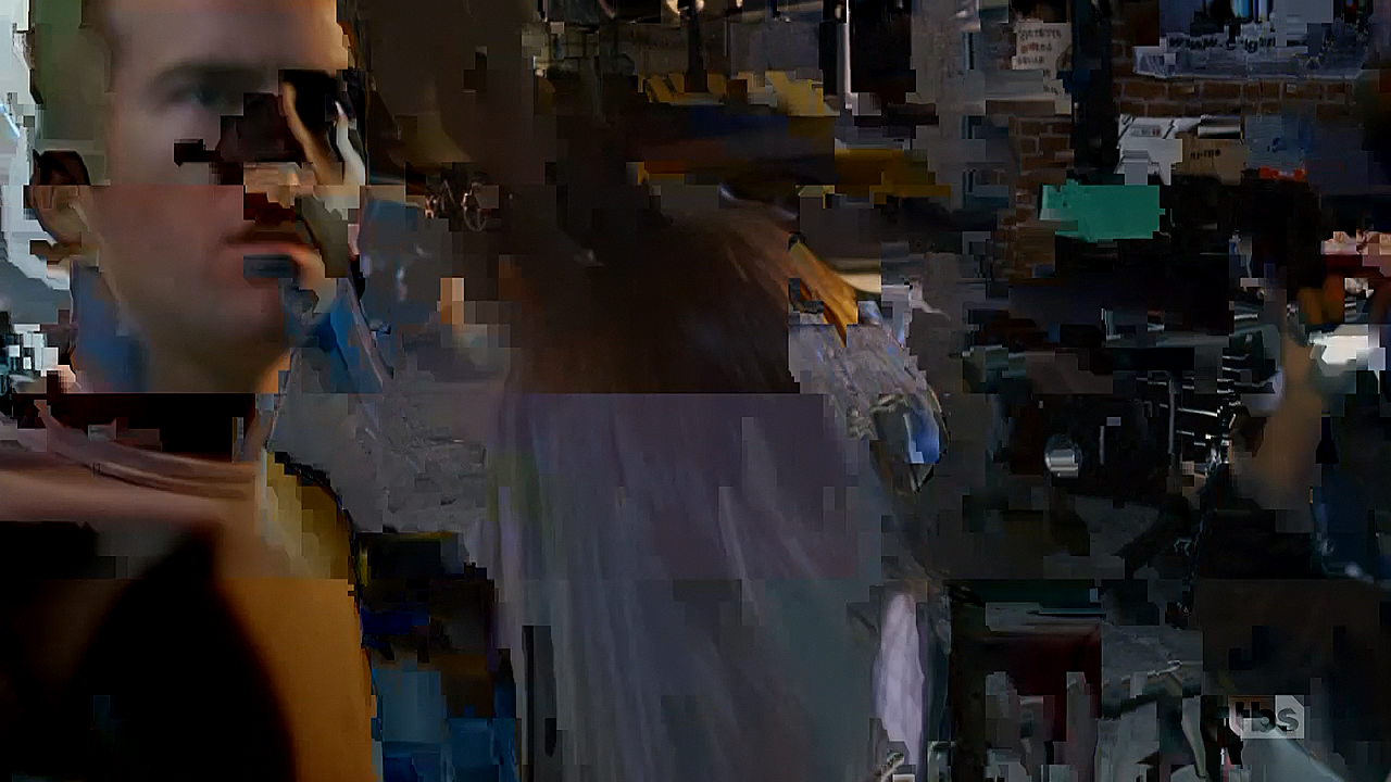

TBS, and a few others TVE channels are breaking up, pixelating alot today
I went to the online web stream for them on thier sites and they play fine.

this is example of what the issue looks like. i submitted server diags and did submit via the app.
i does it same on web browser playback and using the http m3u link.

Tuned to TBS
Does issue right away and constantly.

TBS and truTV are both Warner networks; since those seem to be the only affected channels, it's most likely a problem with the stream they're serving.
(Edit: Interestingly, it's only the Eastern feeds of those two networks; no other Warner network seems to have the macroblocking issue. It might be interesting to see if these problem show up 3 hours later on the Pacific feeds; that would definitely confirm a server/encoder issue.)

EDIT: I just enabled the P versions of those 2 channels, and they do work fine. I guess ill just use that version for now, as long as the guide is right, its fine. But, wanted to report it in case it is some Channels issue that can be fixed. if is a network stream issue from the source...then...i guess nothing can be done on my end.

It was on the TBS East feed. It seems to be fine now. I've had issues since Monday.
TBS must have fix it on their end.
