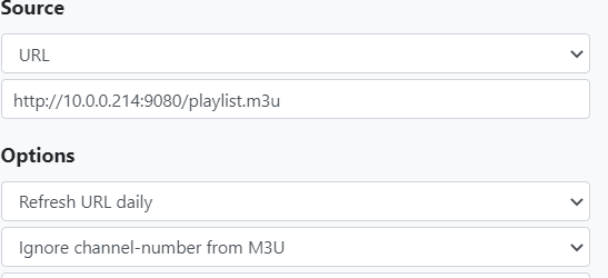

Make sure on the Pluto M3U to ignore channels numbers from M3U and let channels handle them. That will number the Pluto Channels in the 9000's.
and just like that….
Thank you I never thought to look there….
Thank you very much
