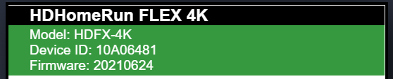

This seems to be live watching only. The saved file (if recorded) doesn't seem to have any artifacts in it.
Any ideas?
Any ideas?
Perhaps try the current (20220203) firmware?

Any corresponding messages in your DVR log? Might be worth sending diags on, so the devs can see if the client is yacking on something.
Also - would be interesting if the SiliconDust client works better.
Had weather, family health issues, haven't watched any live TV since "the big game". I updated the firmware, though. I'll try to find something sports-likes with lots of motion (seemed to be a trigger) to see what I observe.
