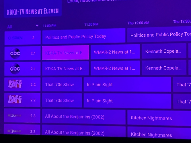

Here is a photo of my TV screen, showing there are two "2.1" channels, which is correct - One should represent WMAR which I am receiving through an antenna HDHomeRun and the other should represent KDKA which I am receiving through Locast. You can see that even in the guide data, it shows one show from EACH channel in BOTH lines, vs. having the separate guide data for each channel on one line properly: (Sorry for the horrible blue.. yes there's something wrong with my TV but it doesn't look like that in person!!)
No matter which of these versions of 2.1 I watch, it tunes the HDHomeRun channel, which is higher in the priority list.

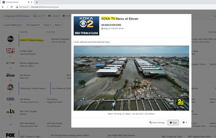

So, I went to the web client and found the EXACT same thing happening. On the web client, I decided to filter ONLY on the one source, to try to force it to show me the KDKA show and although it thinks it is showing the KDKA show you can see in the bottom right, it is really the other channel:
