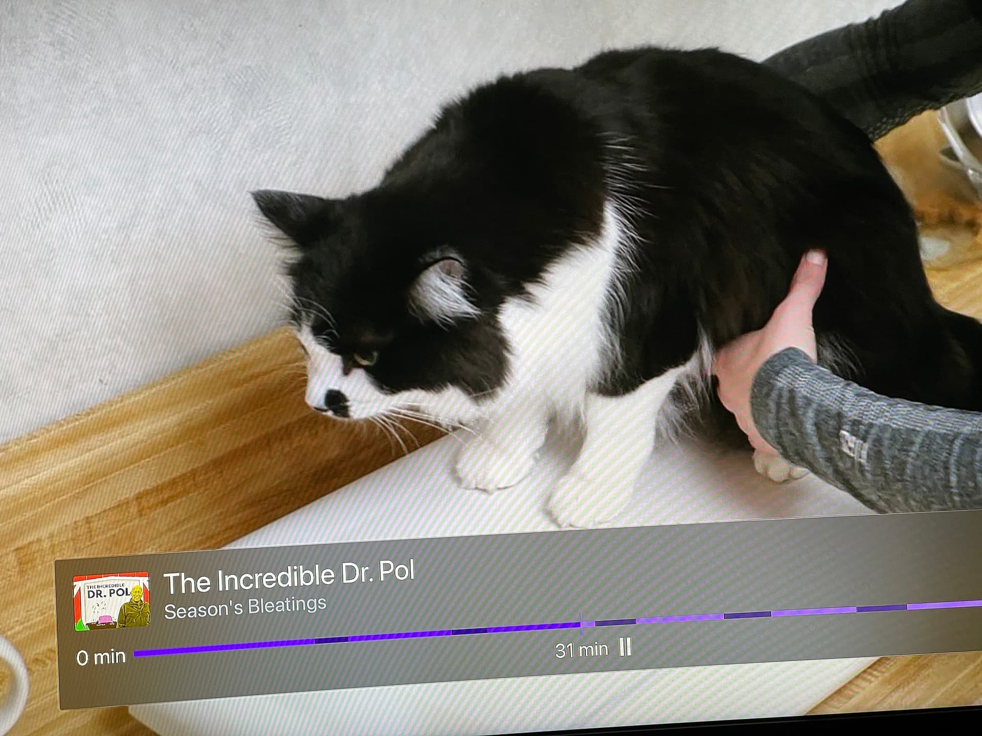

FF several min in, pause, back out, Page not updated.
2nd recording, FF 31 min in, watched a fin min, same thing, Circle not updated.
