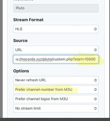

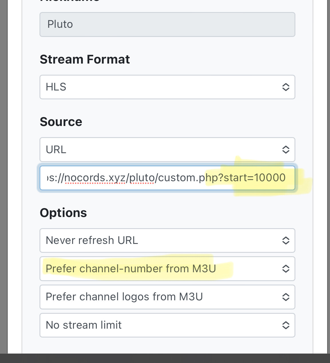

There's a setting in the custom channel to ignore channel numbers
Thanks for the response, but can you expand a bit? Pluto streamed channels come from their M3U file, how would I move their channel 200 to something like 21 and have it stick as they update?
You change it in the custom source settings.
If you use nocords as your source for Pluto you can just use start=10000 or whatever channel you want to start them on.
Otherwise you can change prefer channel numbers from m3u to ignore channel numbers from m3u and the server will assign numbers that don’t overlap usually in the 9000.
