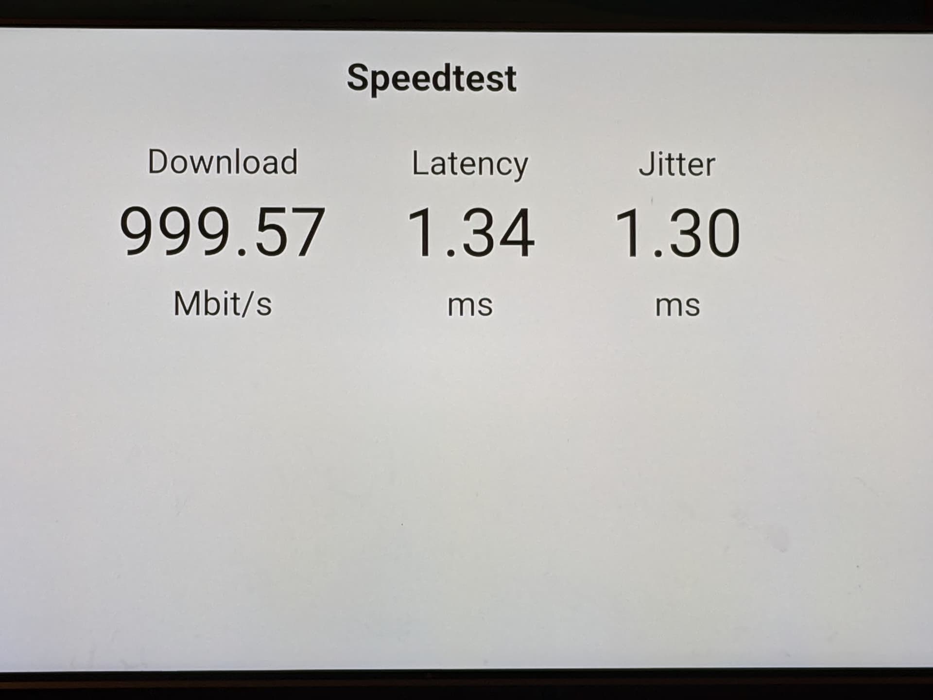

In Channels app on your SHIELD click Settings > Support > Test Speed to DVR and post the results

I disabled commercial detection , then restarted the NAS
After reboot, the stuttering issue I was encountering was gone - after a day, I re enabled the commercial detection feature and the problem was still gone
I dont know if rebooting the NAS or disabling commercial detection was the fix, but both are easy enough to do. Maybe a combination of the two
