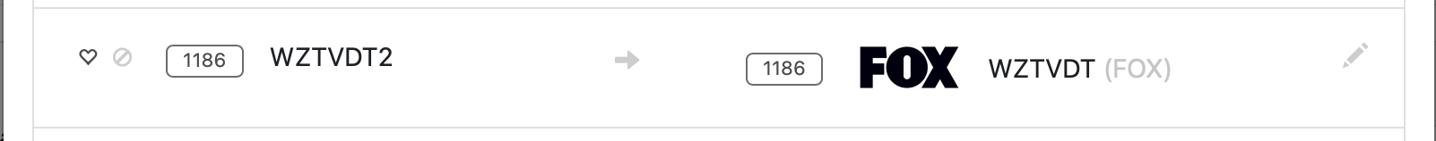

I tried. I've attached a couple of screenshots showing the issue.

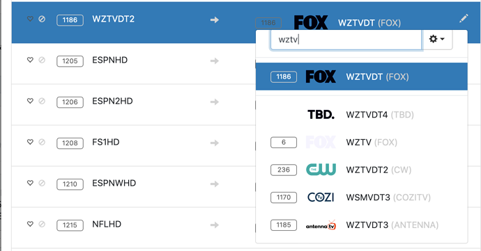

The first one shows the channel 1186 (WZTVDT2) is mapped to tuner WZTVTV (which is wrong). In the second you see that trying to type WZTVDT2, which is the correct call sign, shows that 1186 is mapped to WZTVDT (which is totally wrong). 1186 is the CW (WZTVDT2) but it's mapped wrong interrnally.
select 236 CW WZTVDT2 from the list?
you see that WZTVDT2 is connected to 236 (which is the SD version of the channel)
I did that. not optimal as that is the SD version of the channel. It seemed to "fix" the scheduled recordings as my Fox recordings do now appear to be using 1017 but clearly this thing is jacked up. the guide data should have that 1186 is the CW but it doesn't.
