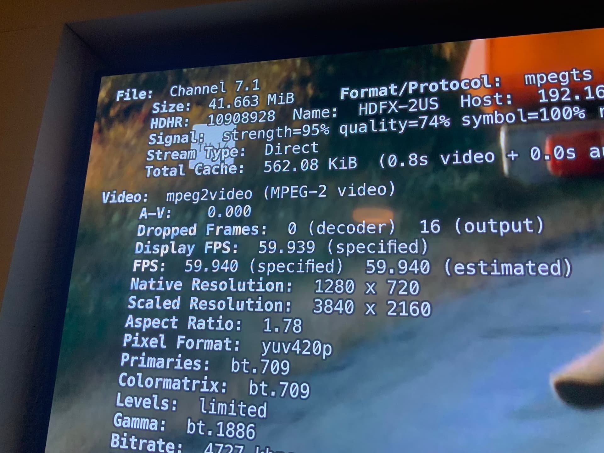

Thanks for the response! That's what I thought, but every time I check the signal manually it's 93-97%. (currently 95% at 9:20 PM - see pic)
I wonder what makes it drop from 7-7:30 PM every night... Maybe I'll switch to trying TVE for local networks.
