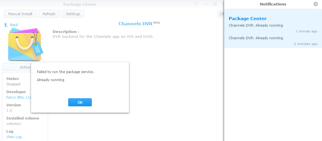

I just downloaded the SPK on the DVR page (ChannelsDVR_1.0.0.spk) but it still shows the that the service is stopped. Should I get 32 bit build somewhere else on the site?
That spk should work. Did you remove it first (if you had attempted to install before a few days ago).
Can you post the error message or logs?
I installed around an hour ago for the first time so I didn’t try uninstalling. The only error I can see is a statement that line 12 cannot execute.
If you could paste the entire message or take a screenshot that would help.
Just got a new error message that states that the service is already running.
