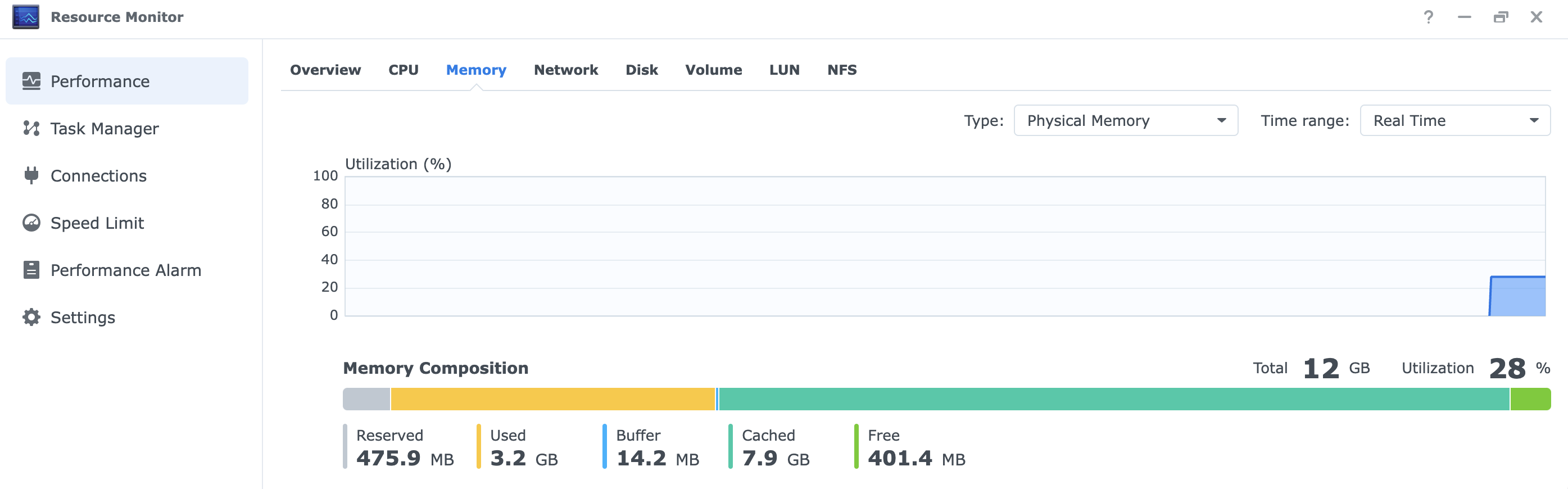

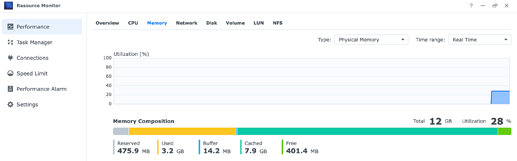

Are you seeing anything unusual in Resource Monitor-->Performance-->Memory?
Or Channels DVR memory use in Resource Monitor-->Task Manager-->Services?
BTW these screen caps are from a DS920+ running DSM7.
