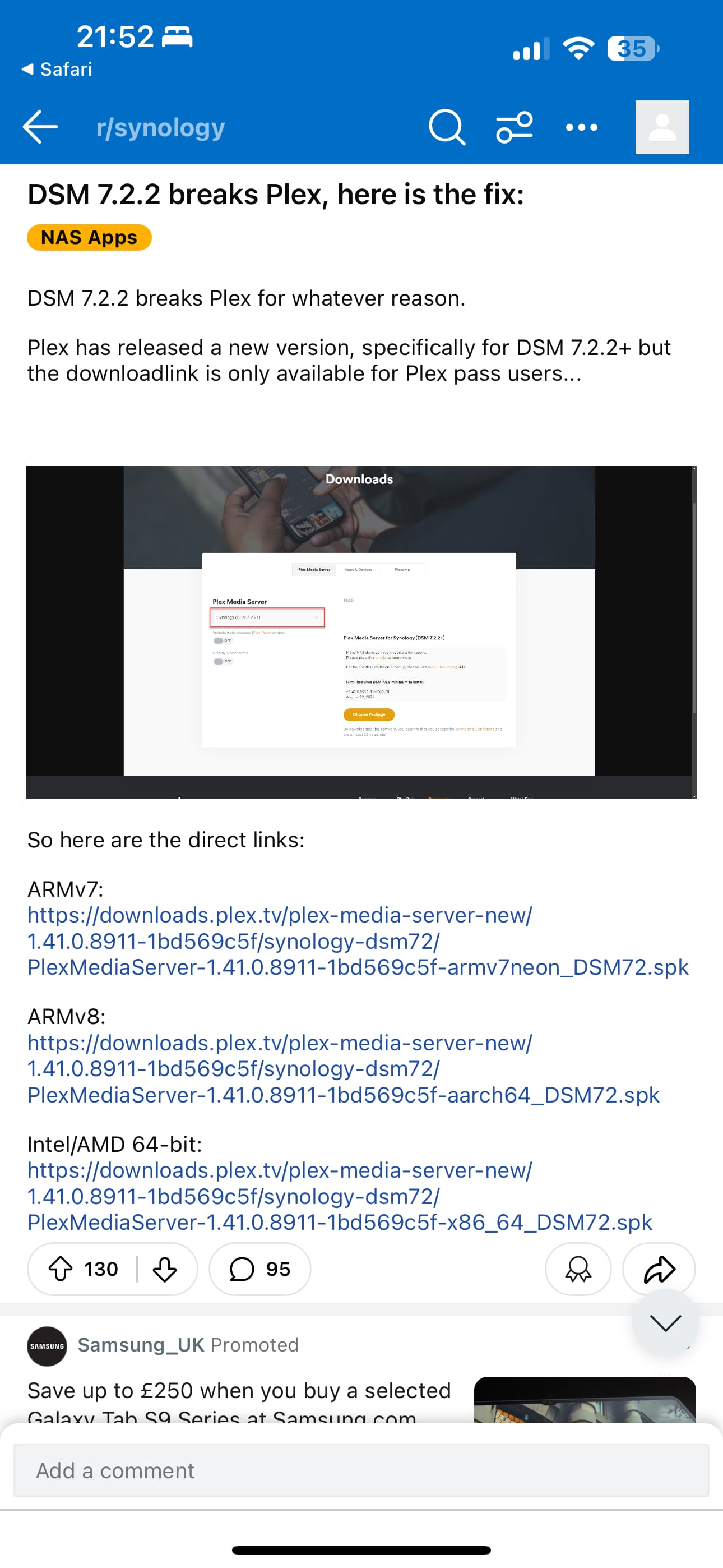

Plex had to release a special version for 7.2.2 due to the codecs being removed
