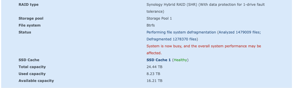

I did a little trial today and moved my entire DVR directory over to an External USB3 drive that is connected to my 2018 Mac mini. I did this because here lately I've noticed that my TVE channels are tuning ridiculously slow. I've also noticed that my image icons for shows would lag and take 10-15 seconds to load when I would goto the On Now tab.
Switched everything over, connected an ATV4 to test. Everything is instant now.
I'm trying to understand why my Synology would be hurting so bad to tune everything? I don't have a lot of things running on it. CPU load is under 10%, memory is around 28% and about 30% disk space used.
I have 3 14TB WD Easystore drives (shucked) in SHR1. SSD Cache (which I know may not be doing much benefit but can't hurt). I felt like the Synology 1019+ used to run Channels just fine. I don't get what's going on now. Anyone have any thoughts for me to try?
The only thing that I can think of is that the 14TB drives are just too slow to use for the DVR.
Did you try defragmentation on you Synology drives. Somebody had told me that the SSD Cache was more of a problem so I never bought them so maybe you can try removing and see what happens. Something about getting that Cache corrupt I don't know that the only reason I did not get them and the way mine runs I don't need it on the DS720+ (Just a thought).
I have not tried defragmenting but am doing that now....it has only been running for 10 minutes and I'm in shock

It sped up the loading of the icons but starting a transcode stream is still really slow.

check the load averages. These can be high (over 4) if your io wait is high... even when cam and ram are low.
I failed to yield my own advice....if all else fails, reboot.
A reboot fixed it. :tired_face:
