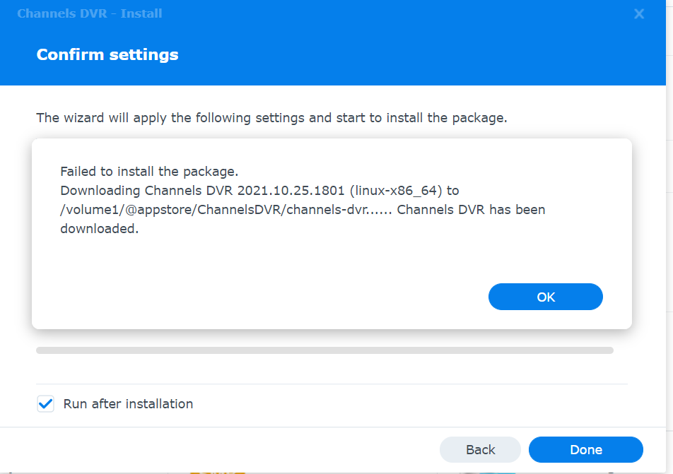

Synology Install error
Trying to transfer server to Synology DS920+ and getting an error

Only thing I can think of is the DS-920+ has problems downloading files over the internet to complete the installation.
Try installing again but uncheck this box.

I followed your recommendations but still got the same error message and no shared folder was created.

Appears it downloaded its code to /volume1/@appstore/ChannelsDVR/channels-dvr
But it was supposed to create the shared folder /volume1/ChannelsDVR on install.
