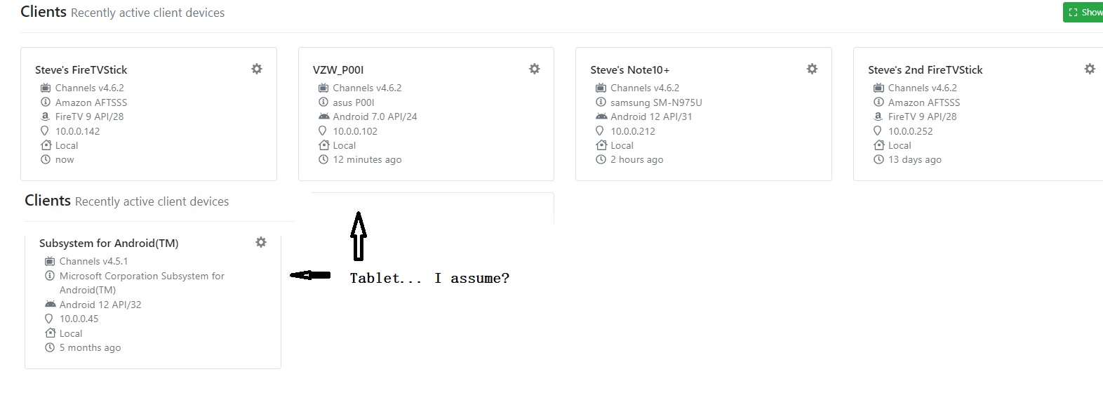

see attached picture... on server I removed what I think could have been an older version of tablet and now it seems to be working fine ... so far.
