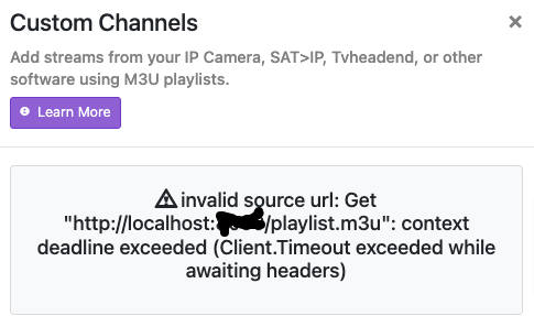

Talbo running in Docker enter into to custom channels and gets this error!

When I tried the 127 playlist I still receiving this error invalid source url context deadline exceeded (Client.Timeout exceeded while awaiting headers)
