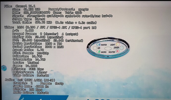

I took this pic with STATS on screen, mere moments before the screen blanked out with the error.

Strange enough, the Tablo is the last tuner in my list after my HDHRs (by default and after moving priority around) but it is definitely the first tuner chosen to watch or record. And as you can see in the picture, it looks like it is named with a HDHR title.
