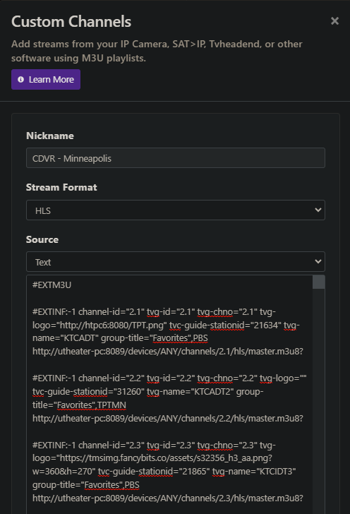

Having said all this, I'm using an HDHomeRun remotely myself, and am quite happy with it. I'm also using Tailscale, but I have a Channels DVR server both remotely and locally. This allows for the remote server to easily access the remote HDHR and transcode the stream to travel via my Tailscale network.
Using a Custom Channels setup in my local CDVR, I can then add these remote channels to my local guide with an setup like this:
