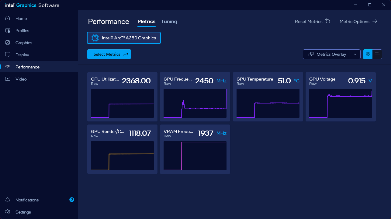

Here's the GPU performance with a single stream:

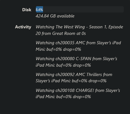

I'm currently streaming 4 channels with Charon, using CDVR Multiview on an iPad.

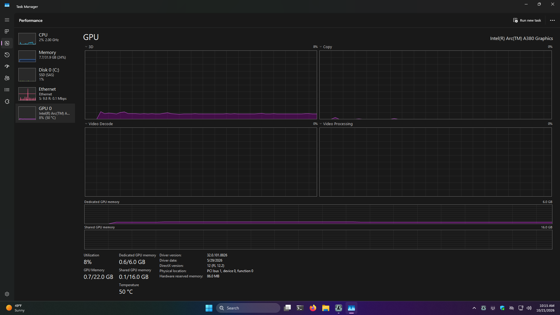

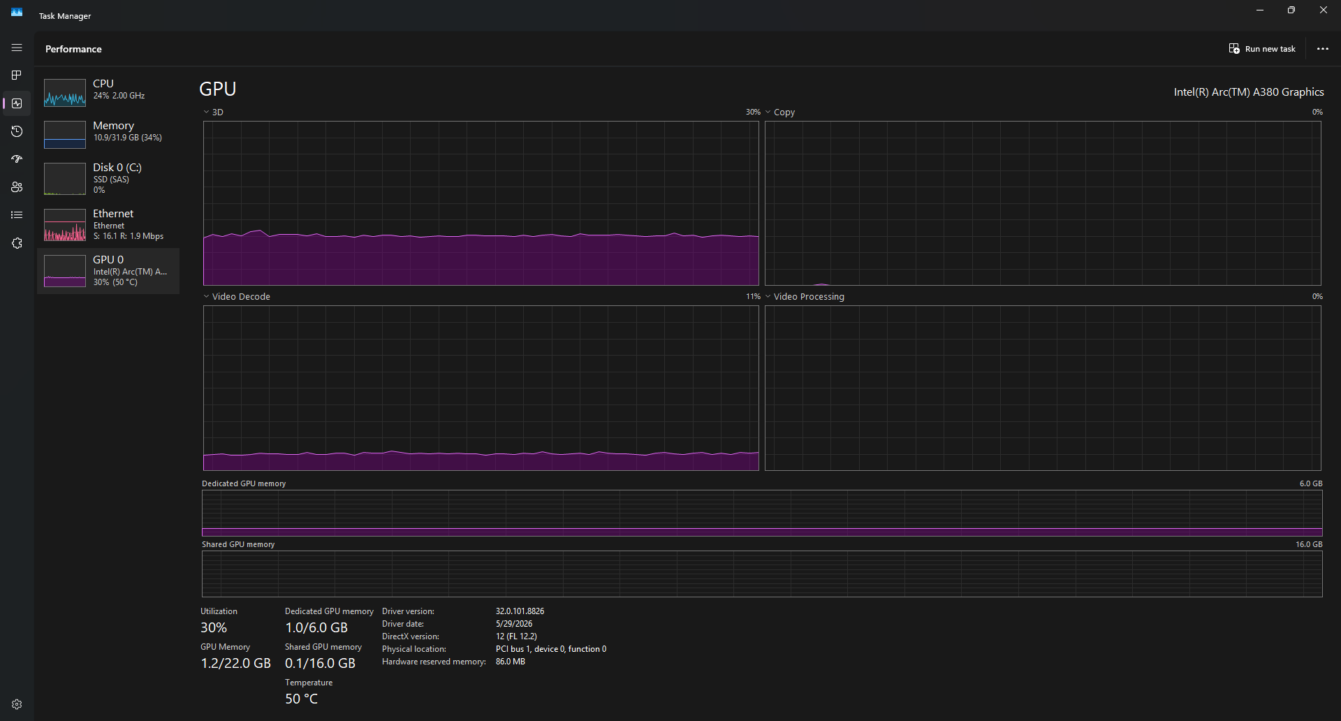

Here's what the GPU load looks like:

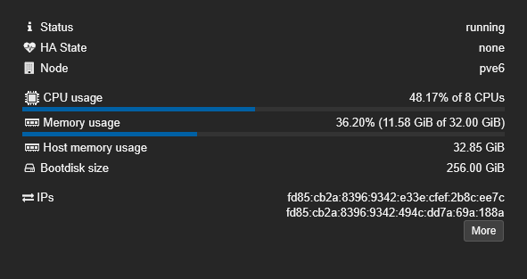

And the resource utilization for the Windows VM on Proxmox:
Screenshot 2026-10-21 at 13-18-51 pve6 - Proxmox Virtual Environment

Nice. Thank you for the data. Is it keeping up or dropping frames?
I'm going to work on Spectrum as a provider very soon. I will probably need some testers when I get it done. Thanks.
I don't think I can get stats on Multiview. Is there another way to get that data? It looks fine, but it's an iPad Mini. :slight_smile:

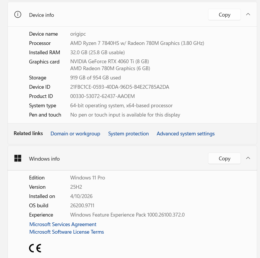

I would love to help, I have a windows 11 machine (AMD CPU/GPU) and YTTV.
