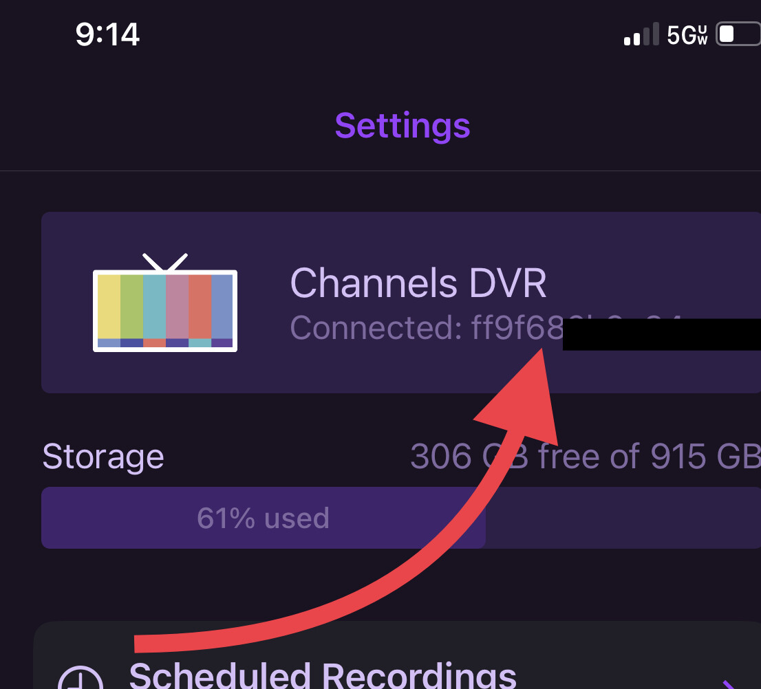

FYI in the app under settings if you see letters and numbers you’re attached via normal remote 8089. If you are attached with Tailscale it will show your dvr’s Tailscale ip 100.ect.
Yes! Thanks for the info. I will remember that now
