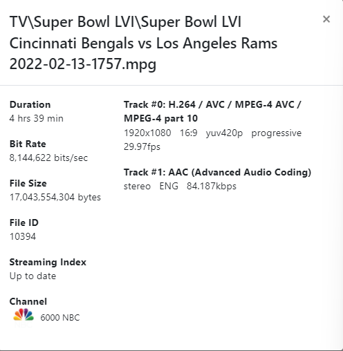

Not to be a hater here but did you try and record it and look at the details in channels? I'm pretty sure the tve feed is national and audio is 2.0 but I could be wrong. My tve sounds great and appears to be 5.1 but it's my marantz doing 5.1 virtual (sounds great enough for me but isn't true 5.1)

Do you have a recording of it by chance so you can check the details?
Details for WNBC (no 5.1 :frowning:):
