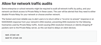

You might want to let Apple know about that then, they specifically state NXDOMAIN.
Could you provide source?
Already did, and a screencap of what you see at that link:
The fastest and most reliable way to alert users is to return either a "no error no answer" response or an NXDOMAIN response from your network’s DNS resolver, preventing DNS resolution for the following hostnames used by Private Relay traffic.
If you want to block everything in a particular domain then NXDOMAIN is appropriate. However we were just talking about blocking only AAAA/HTTPS records. Answering with NXDOMAIN will prevent access to other records, including A records. That's why NODATA needs to be used.
Let Apple know their documentation and engineering staff are incorrect then.
I would love to do that but they are correct. Where is the problem?
