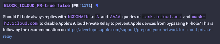

Since you asked, when I setup PiHole and was using it my iOS devices would constantly hang when loading pages in Safari. I eventually discovered I needed to set BLOCK_ICLOUD_PR. It would be nice if that setting was better documented, available via the UI instead of just env var, or if PiHole wasn't broken by default for iOS devices.
Yes, as the old adage goes: "It's always DNS". But that isn't something that is limited to Pi-hole of course, any and all DNS sinkholes are in that realm. We do make it very easy to exclude certain devices from any blocking so you don't have to manually configure the client(s) or segment the network management with multiple DHCP pools.
That is not the intended behavior and not something I've seen much of. The documentation for that feature is at Configuration - Pi-hole documentation

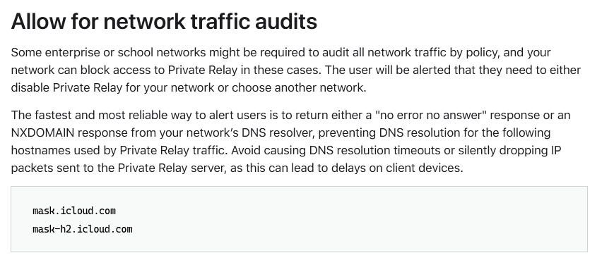

and it is based on the Apple recommendations for allowing traffic audits Prepare Your Network or Web Server for iCloud Private Relay - Support - Apple Developer
Private Relay will bypass your local management and will render Pi-hole useless.
Private Relay protects users’ web browsing in Safari, DNS resolution queries, and insecure http app traffic.
If you would like to we can examine that issue further but we have many users on iOS and I don't think it's an accurate statement to say that Pi-hole is broken by default for iOS devices. I'm sure I'd have a few tens of thousands of users screaming for my head on the reddit sub if we ever did that.

Pi-hole is set to answer queries to those two canary domains with NXDOMAIN, very similar to the Firefox DoH canary domain process.
Private Relay is incompatible with any locally set DNS server, among other things. Everything goes to Apple's infrastructure, DNS, and proxy servers when Private Relay is enabled.

The answer should always be NODATA. Answering NXDOMAIN is asking for trouble.
