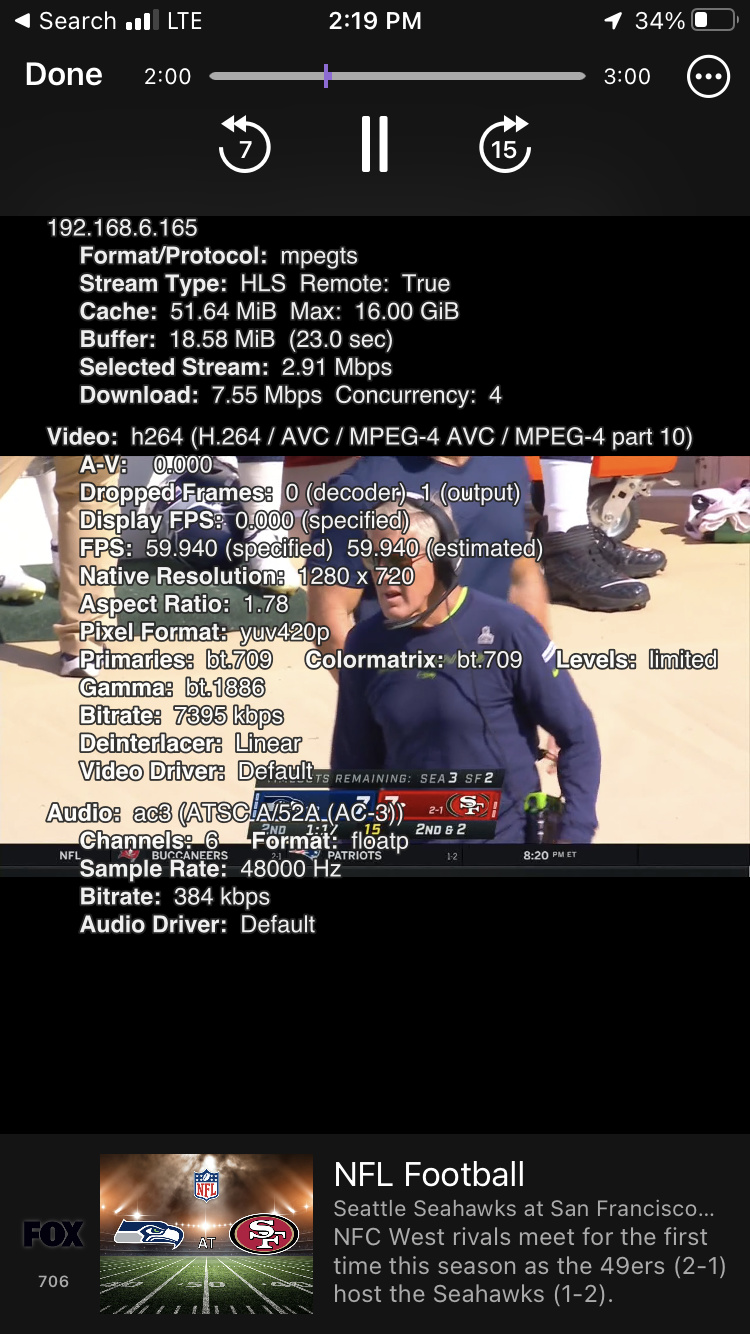

If I stream a channel directly with a selected speed of 4Mbps the stream is constantly being streamed at ~7Mbps. It streams at ~7mpbs based on iftop, "settings webpage of server" and the "show stats" option. I've tried other streams and it is hit or miss. I'm streaming a live channel so there isn't a big buffer, and iftop shows the average stream over 40 seconds of around ~7Mbps.

The Selected Stream references the selected bitrate of the stream being used (which impacts the total data used to watch the recording). Download refers to the measured rate of how quickly the connection is able to download data.
We download as fast as the network connection allows.
I understand that, but this is a live stream. The buffer is staying constant because it is basically live 1-2 seconds behind.
I just noticed the Video Bitrate being reported towards the bottom is also showing 7mbps. You’re right something is going wrong here. Are you using hardware or software Transcoding on the DVR?

This is an interesting issue. It does look like the problem is that the bitrate we're getting from the cable channel is varying more than we anticipated. We take the sampling of the bitrate when we start streaming the channel and it's only 4mbps which causes us to decide to remux it. Then later it goes up to 8mbps.
We'll have to talk internally about this, but we may have to force transcoding on Cable H.264 channels even if the bitrate at the level that we could transcode because we won't be able to predict if it will go up later.
