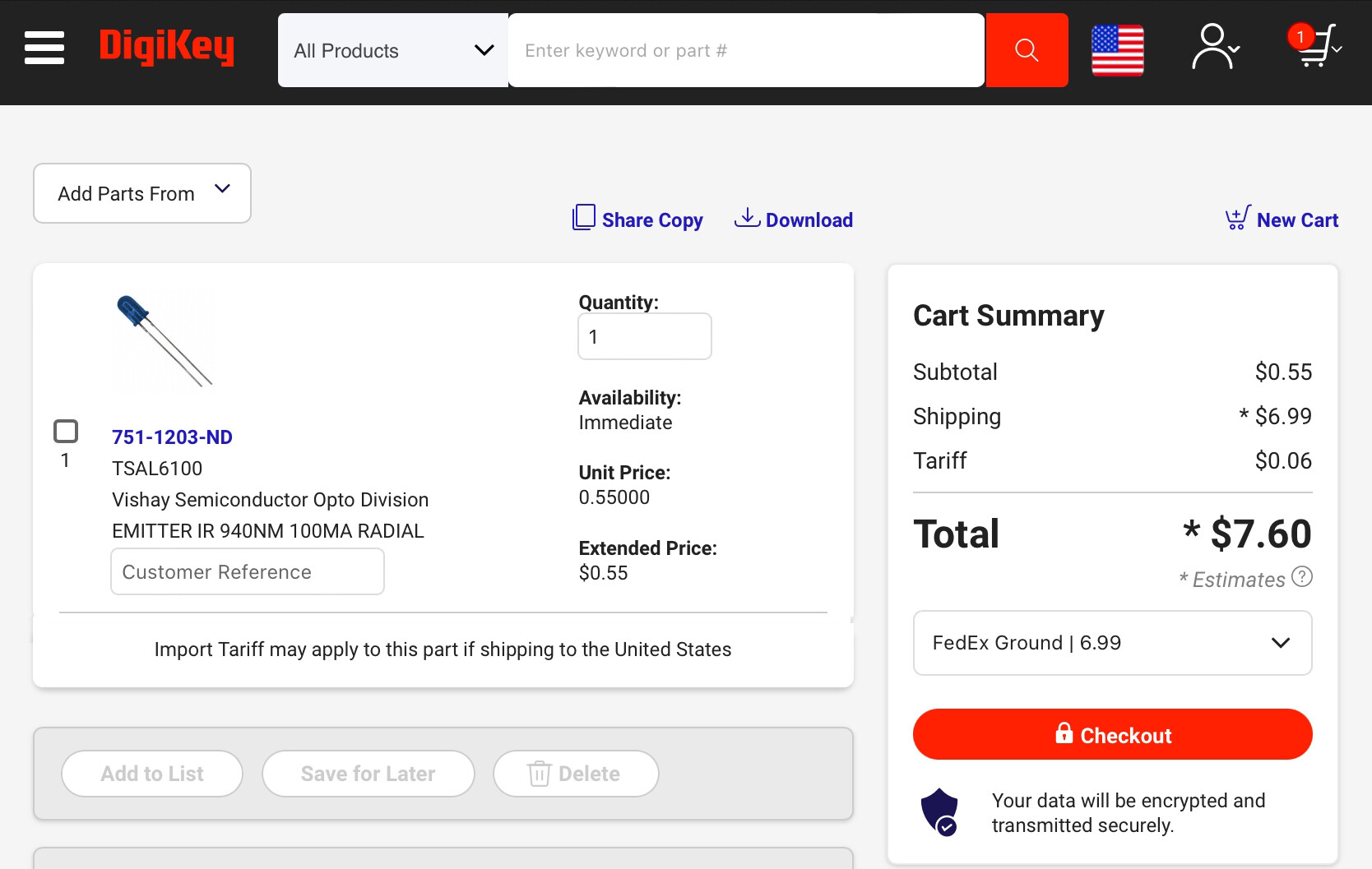

U1 IR Range update
I received a replacement IR transmit led earlier this week.
After hacking my remote the range of my U1 sofabaton has greatly improved, and Ive even noticed much better “off axis” performance.
Your milage may vary, but so far I have had absolutely no issues with my equipment missing signals when running macros and other commands. It definitely feels more snappy.
If you are handy with a soldering iron and want to take the plunge, here is the thread that I followed with instructions.
The LED is .55 on digikey..
Some of my personal notes:
1: If you are picky, you may be able to carefully dremel out a cavity in the front of the remote case to seat the new LED as shown in the AVS formum thread.
I DIDNT BOTHER. I just dremeled out the front cover surrounding both the transmit LED and the receiver LED (used for learning codes). It still looks cool (kind of cyberpunkish) and more importantly IT WORKS.
2: I carefully used copper braid to desolder the existing LED. I DONT recommend a solder sucker - you might pull the pad of the PCB and ruin the connection. If you dont know what copper desoldering braid and a solder sucker is, than you probably shouldn’t be replacing this IR led. Get a techie friend who has a quality Weller soldering iron with fine tip to do it for you.
3: Pulling the case apart is a finicky process. Your milage may vary. There is a tab on the battery end of the unit. Be patient.
