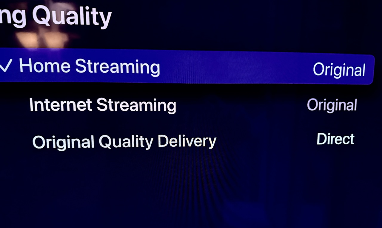

All the streaming settings are set to Original, and Original Content Delivery is set to Direct. Let me know if there are more settings you would like to know about, or more information I can provide.

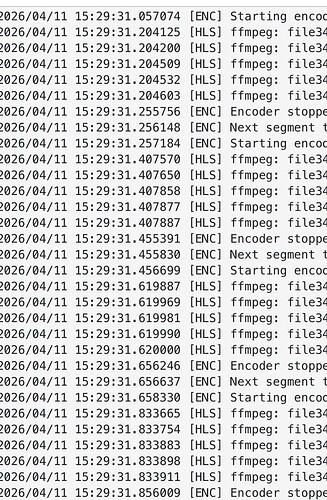

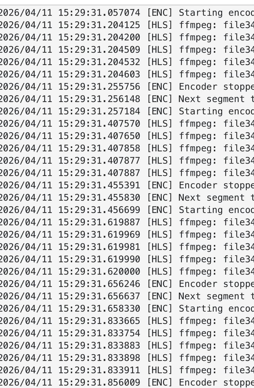

These are part of the logs from playback that made me assume it was transcoding video. It’s ffmpeg that is maxing out the NAS.
Yes, I do see those happening from a remote client that you have connecting and trying to watch HDR content remotely which is having problems transcoding.

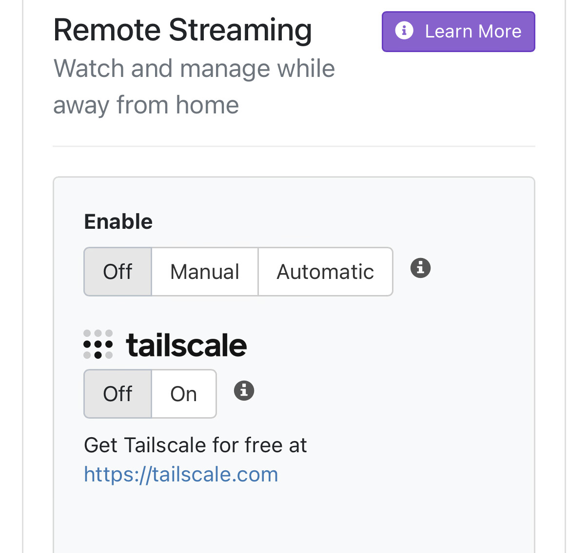

I looked at the DVR settings and they show remote access is off…

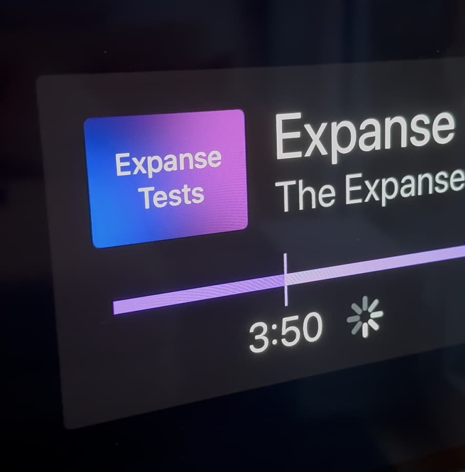

Is this the spinner that you saw on your screen before you submitted the diagnostics from your Apple TV?
The diagnostics from your Apple TV show that you hit play and 2.14s later it started playback and 1.69s after that you stopped playback by hitting the back button. so if that series of events doesn't line up with what you did, it would be helpful to have a video and a diagnostic log from the same session to help understand if there's something that is going on in the UI that doesn't line up with what the logs say.

Yes, I only played a problem video for a few seconds before sending the diagnostics. You didn’t ask for anything specific. Most videos play instantly. The problem videos show a spinner for up to a few minutes, it might play for 20-30 seconds then it stops playing and the cursor spins again.
