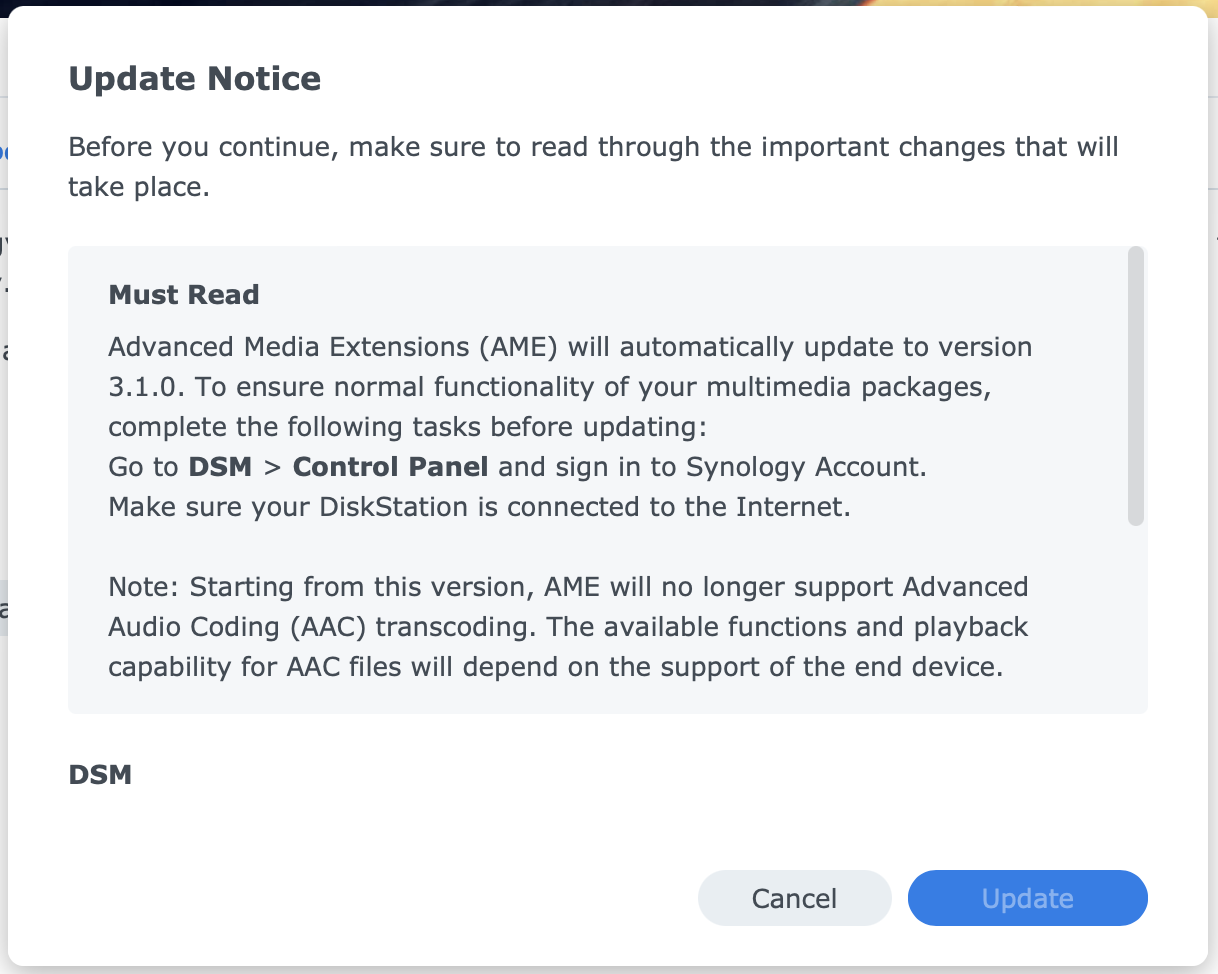

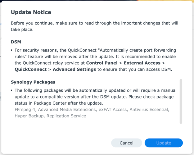

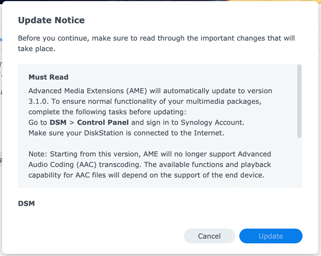

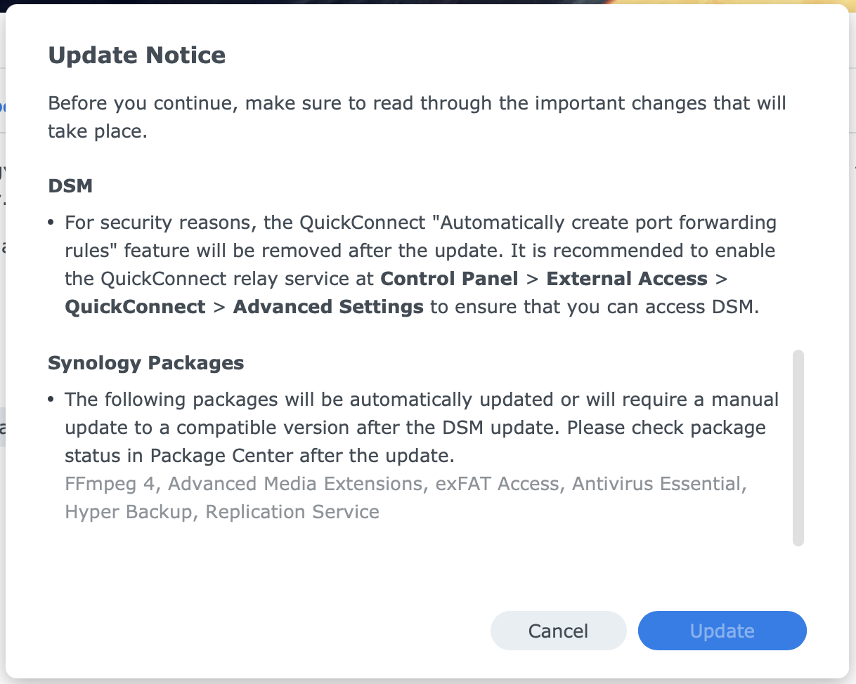

I received a pop up message while starting to upgrade my Synology NAS to 7.2.
I immediately stopped the upgrade until I could verify the changes would not affect my transcoding.
I'm still working on that. You cannot downgrade the Synology upgrade, so I want to get all things right.

AME Advanced Media Extensions is only used by Synology software, not Channels DVR.
Quick Connect is used to access your Synology remotely, it is not used by Channels DVR for remote access.
