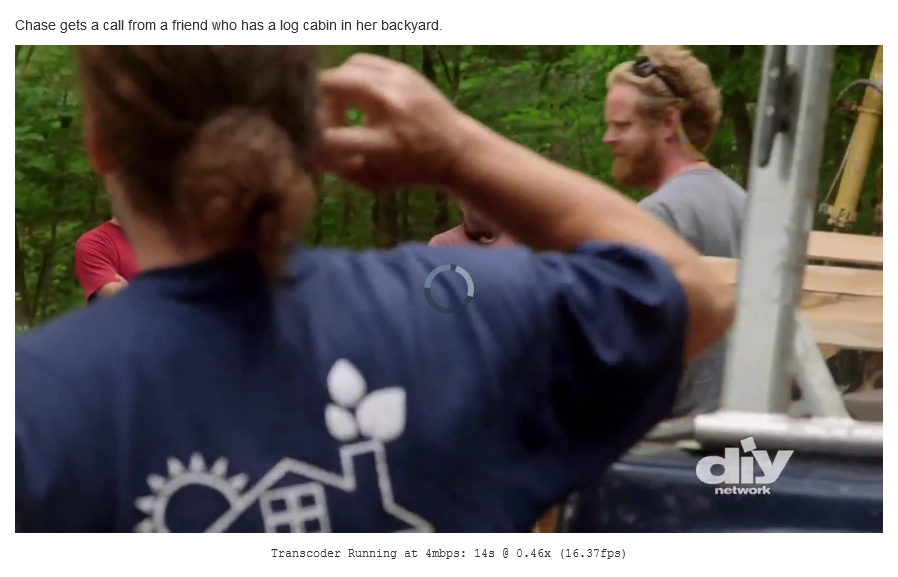

Playing a TVE stream Live locally to a web browser with setting Web Player Server Quality 1080p@10mbps
It's transcoding instead of remuxing and can't keep up with the Live feed, so keeps pausing and stuttering.

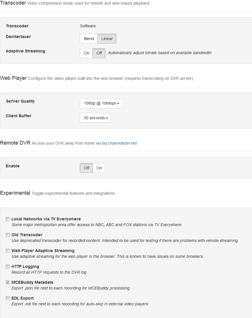

I changed all the settings for Transcoder, Web Player and Experimental, then changed them back.
It now works. :man_shrugging:

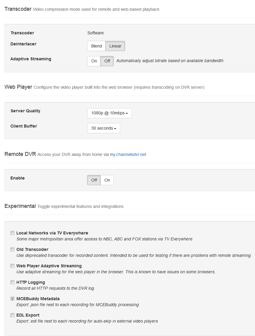

Duplicated it. It's transcoding TVE Live viewing in Firefox.
web UI Settings screen and settings.json agree with each other, except there's no entry in the settings.json for Web Player Server Quality or Client Buffer
"transcoder.deinterlacer": "linear",
"transcoder.disable_adaptive_streaming": "true",
Live%20transcoding%20activity
Just opening the dropdown for Web Player Server Quality and not making any change created the necessary entries in the settings.
"transcoder.bitrate": "10000",
"transcoder.resolution": "1080",
