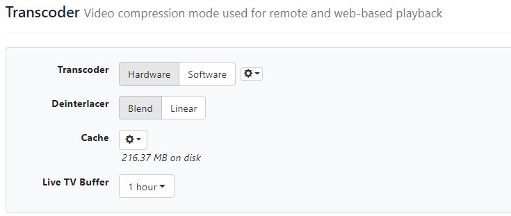

Please screenshot or copy/paste what it shows on the DVR settings page under Transcoder > :gear: > Debug
h264_amf

If I'm in Hardware mode I get 5 seconds of video then buffering, then 5 seconds, etc.
Software setting plays straight through....
Oh so hardware mode does show up?
When you watch in the browser with hardware mode, what does it show underneath the player for speed and fps?
That's the problem then, 10fps is very slow. Are you sure there's no driver updates available?
