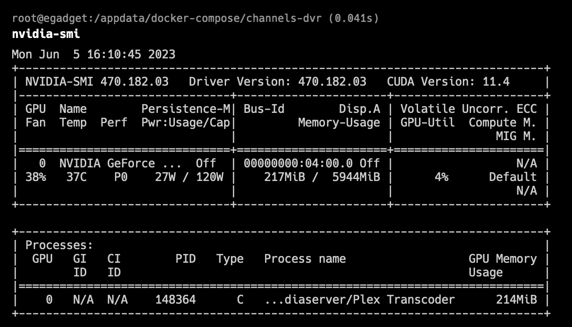

Here's how I have Channels DVR set up in Docker Compose. I already have my Nvidia GPU (GTX 1660) hardware transcoding in another container (Plex).
I can see the card successfully when I nvidia-smi inside the channels-dvr container.
But I can only see Software Transcoding as an option in Channels Settings.
Thoughts?
Thanks!

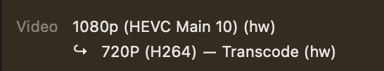

Working in Plex again now, but still no luck with Channels. I wonder if it's a folder permissions issue. I'm rather new to Docker and OpenMediaVault... I also wonder if there's something else I need to do with regards to GPU being used in 2 different Docker containers. I read this is possible as long as I'm not also using the GPU in a VM. I have no VMs...
