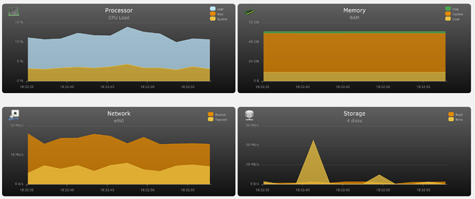

I'm running all this on my unraid server 12th gen intel with 64gb of ram. While stuttering is occurring here are the stats on the server, nothing looks crazy to me.

However, I do think I've solved this. I was checking firewall policies, etc. Then went into the client settings on the firestick and saw a "Test speed to DVR Server" and it was abnormally low (5-7mbps) - for having 2 aruba networks access points and one that is very close, it was oddly low.
So I have a frame tv with the "box" that controls it in a drawer of a cabinet. I opened the cabinet and my speed went from 5-7 to 40mbps+. I'm now not experiencing it anymore. So I need to get a HDMI dongle and run this out of the cabinet so it gets better reception, I think.
