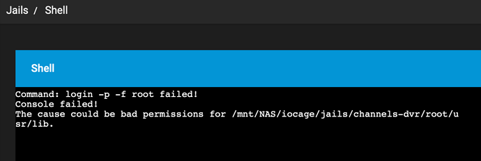

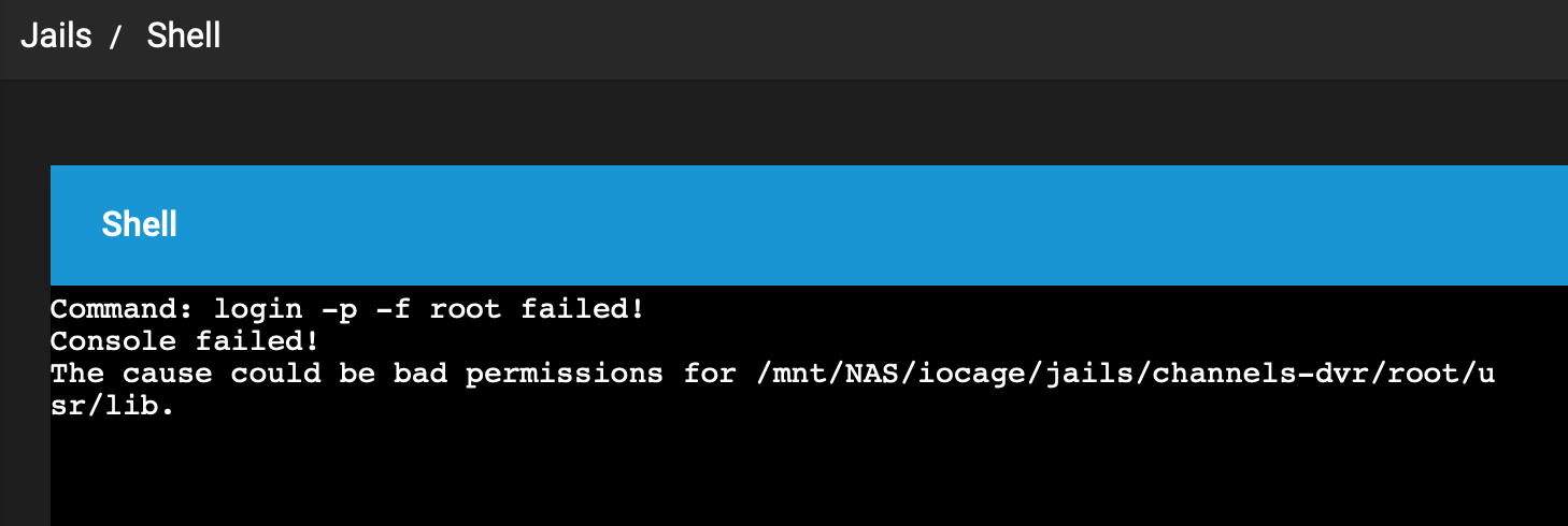

Looks like I won't be able to answer that question until I resolve an underlying error. I attempt to Shell from the Jail interface I get...

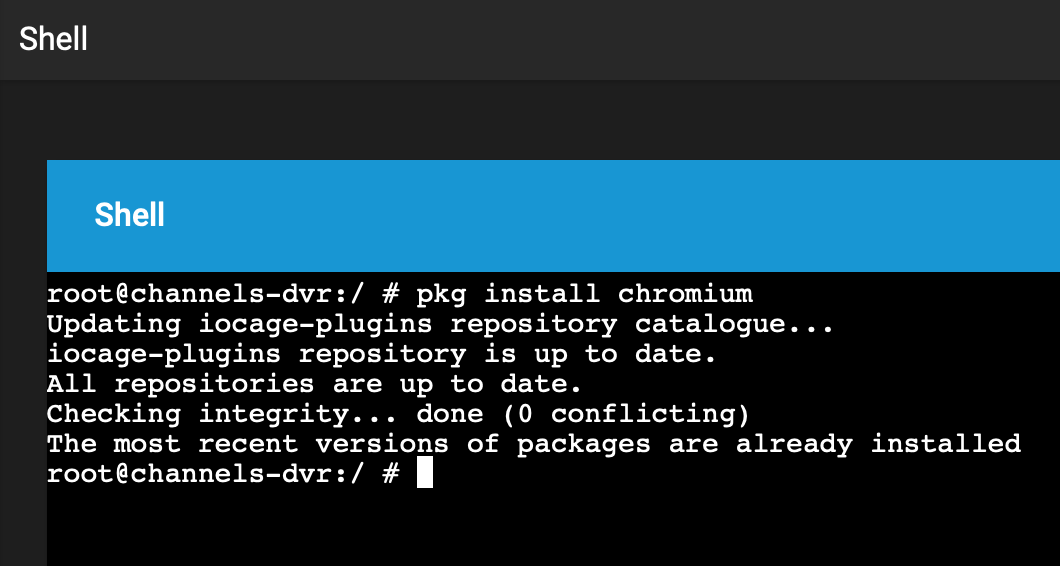

When I Shell from the main interface, execute jexec [jail #] csh, then pkg install chromium I get...
The above is my truenasOLD.local box. I did the same on my truenasNEW.local box and I get "The most recent versions of the packages are already installed."
