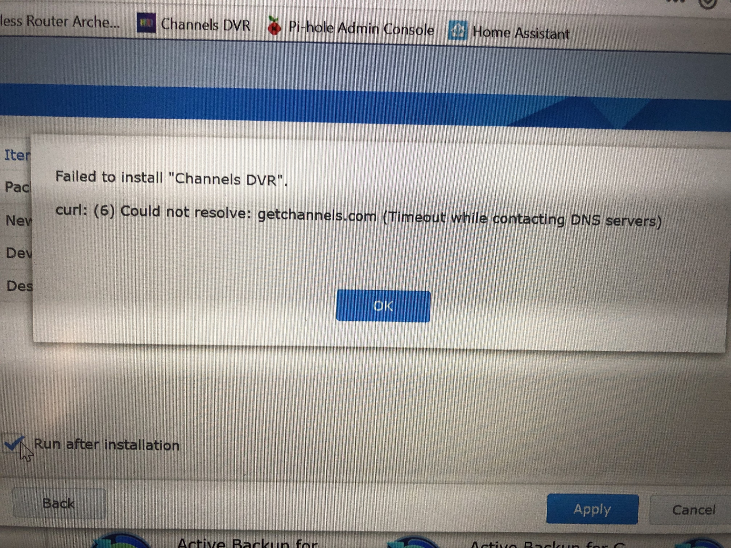

Just tried to install the DVR on my NAS. It did not work. Got the following message

Your dns Network Settings on the NAS are incorrect
You need to go to the Control Panel and check your network settings. It should be located at "Control Panel -> Network -> Network Interface", click the one that says "Connected", and then click "Edit" and go to IPv4 and IPv6 and make sure your DNS settings are in there right.
Or if you're good with CLI just ssh in and run 'cat /etc/resolv.conf' and make sure the nameservers are correct.
Up and running. Thank you to all who replied
