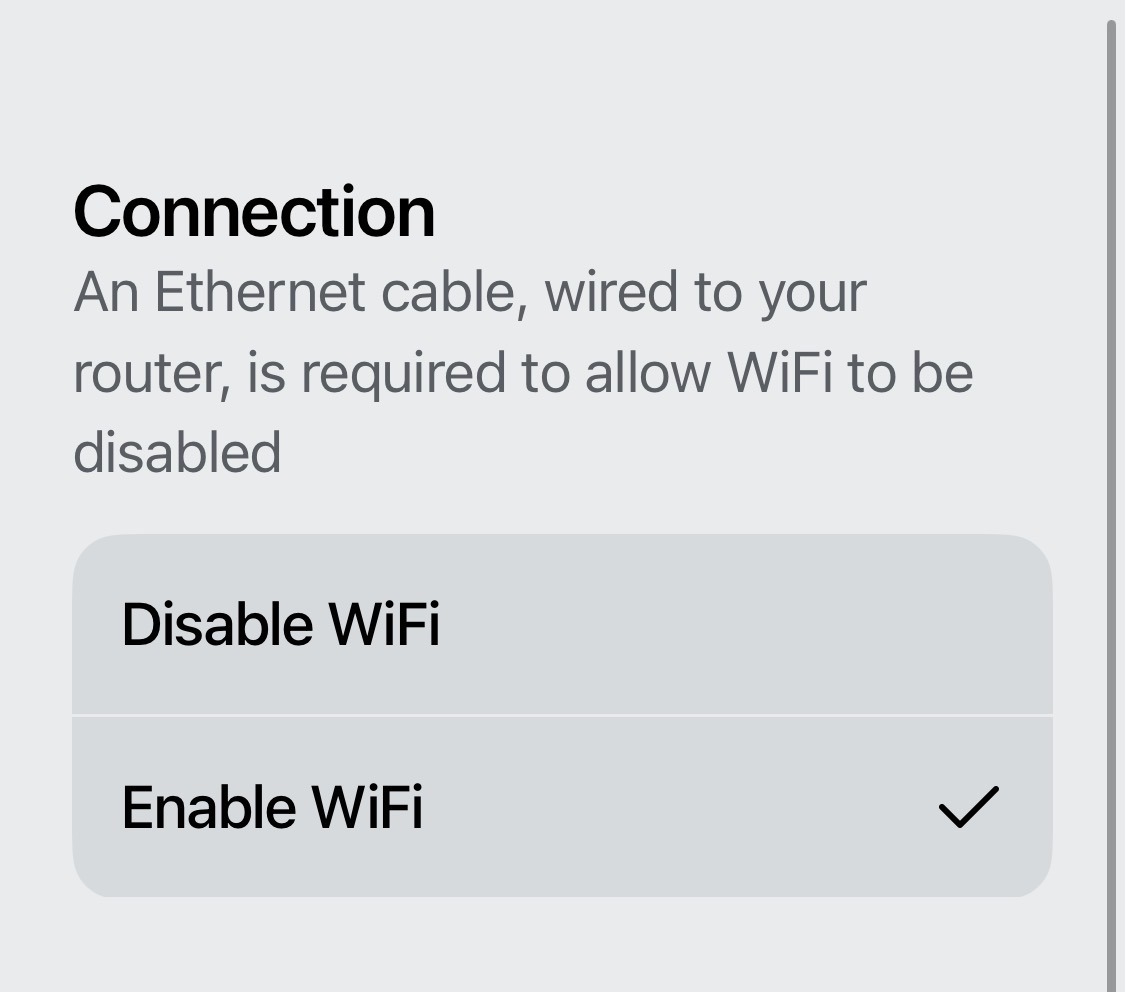

FWIW, any wired device has a setting in the Sonos app that allows you to disable WiFi, to avoid any such conflict:
