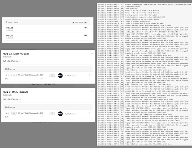

For testing, I currently have 2 m3u playlists with a single channel in each and in the one playlist(m3u_02) the channel is offline but Channels never switches to the next m3u playlist(m3u_01) with the same channel.
I've also tried this with tuners vs m3u playlists with the same result.

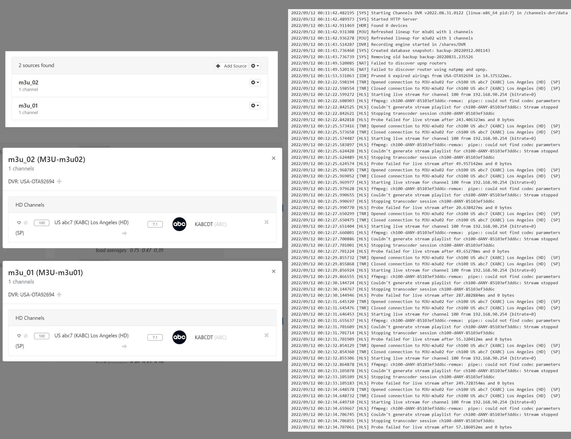

Here is screenshot of how I have it set up.
Can you try from the Channels app?

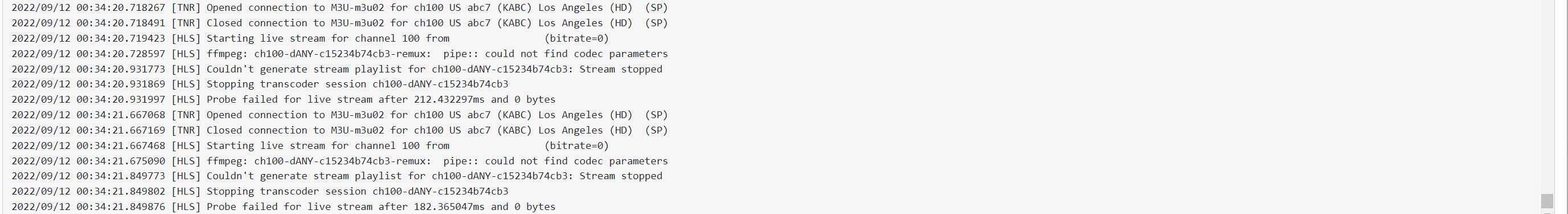

Just tried it in the iOS app and I get a "500 Internal Server Error" but nothing else happens.
Attached you can see the section of the log from the connection attempt to stream m3u02, failing and stopping.
