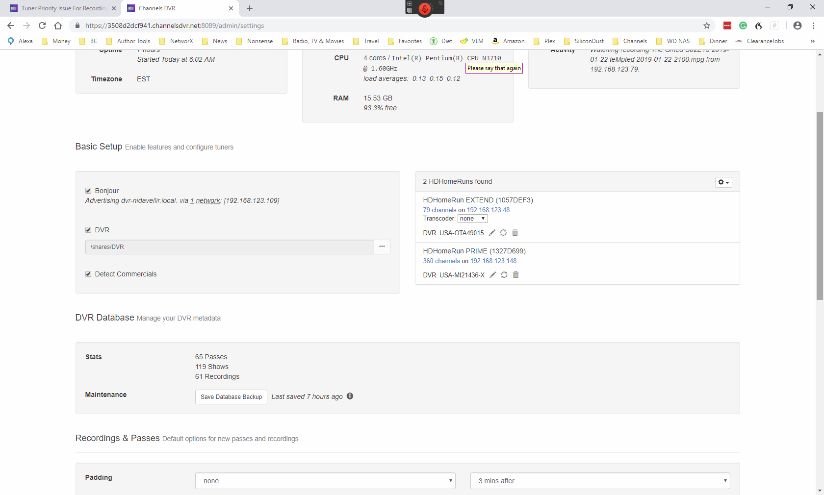

Where did you verify the priority?
The order the channels are listed in the schedule doesn't matter.
Please screenshot the list of HDHRs shown in the DVR web UI, and copy/paste an example of a recording from the Log tab.
Verified in the Settings screen. EXTEND is first, Prime is under it, screen shot attached.

2019/01/30 13:00:00 [DVR] Starting job 1548871200-87 America's Court With Judge Ross on ch=[236 3.2]
2019/01/30 13:00:00 [TNR] Opened connection to 1057DEF3 for ch3.2 [transcode=none]
2019/01/30 13:00:00 [DVR] Starting job 1548871200-88 Friends on ch=[196 22]
2019/01/30 13:00:00 [DVR] Recording for job 1548871200-87 from 1057DEF3 ch3.2 into "TV/America's Court With Judge Ross/America's Court With Judge Ross 2010-09-20 2019-01-30-1300.mpg" for 32m59.966818599s
2019/01/30 13:00:00 [TNR] Opened connection to 1327D699 for ch196
2019/01/30 13:00:00 [DVR] Starting job 1548871200-90 Maury on ch=[234 17.1]
2019/01/30 13:00:00 [DVR] Recording for job 1548871200-88 from 1327D699 ch196 into "TV/Friends/Friends S02E22 1996-05-02 The One With Two Parties 2019-01-30-1300.mpg" for 32m59.574028953s
2019/01/30 13:00:01 [TNR] Opened connection to 1057DEF3 for ch17.1 [transcode=none]
2019/01/30 13:00:01 [DVR] Starting job 1548871200-91 Planet Earth on ch=[114]
2019/01/30 13:00:01 [DVR] Recording for job 1548871200-90 from 1057DEF3 ch17.1 into "TV/Maury/Maury S21E66 2019-01-30 If You Cheated On Me While I Was Pregnant Its Over 2019-01-30-1300.mpg" for 1h2m59.110783791s
2019/01/30 13:00:01 [DVR] Refreshing metadata for Maury (185494)
2019/01/30 13:00:01 [TNR] Opened connection to 1327D699 for ch114
2019/01/30 13:00:01 [DVR] Starting job 1548871200-86 Strahan & Sara on ch=[237 231 41.1]
2019/01/30 13:00:01 [DVR] Waiting 29m58.171400673s until next job 1548873000-88 Friends
2019/01/30 13:00:01 [DVR] Recording for job 1548871200-91 from 1327D699 ch114 into "TV/Planet Earth/Planet Earth S01E01 2006-03-05 From Pole to Pole 2019-01-30-1300.mpg" for 1h2m58.610001161s
2019/01/30 13:00:01 [ERR] Failed to start stream on channel 41.1 via 1057DEF3: got HDHR error: 805 All Tuners In Use
2019/01/30 13:00:01 [ERR] Failed to start stream on channel 237 via 1327D699: got HDHR error: 805 All Tuners In Use
2019/01/30 13:00:01 [ERR] Failed to start stream on channel 231 via 1327D699: got HDHR error: 805 All Tuners In Use
2019/01/30 13:00:01 [DVR] Error running job 1548871200-86 Strahan & Sara: could not start stream on channels=[237 231 41.1]: got HDHR error: 805 All Tuners In Use
2019/01/30 13:00:02 [DVR] Refreshing metadata for Planet Earth (275830)
2019/01/30 13:00:31 [DVR] Starting job 1548871200-86 Strahan & Sara on ch=[237 231 41.1]
2019/01/30 13:00:31 [DVR] Waiting 29m28.097677807s until next job 1548873000-88 Friends
2019/01/30 13:00:31 [ERR] Failed to start stream on channel 41.1 via 1057DEF3: got HDHR error: 805 All Tuners In Use
2019/01/30 13:00:31 [ERR] Failed to start stream on channel 237 via 1327D699: got HDHR error: 805 All Tuners In Use
2019/01/30 13:00:31 [ERR] Failed to start stream on channel 231 via 1327D699: got HDHR error: 805 All Tuners In Use
2019/01/30 13:00:31 [DVR] Error running job 1548871200-86 Strahan & Sara: could not start stream on channels=[237 231 41.1]: got HDHR error: 805 All Tuners In Use
2019/01/30 13:01:01 [DVR] Starting job 1548871200-86 Strahan & Sara on ch=[237 231 41.1]
2019/01/30 13:01:01 [DVR] Waiting 28m58.038656443s until next job 1548873000-88 Friends
2019/01/30 13:01:01 [ERR] Failed to start stream on channel 41.1 via 1057DEF3: got HDHR error: 805 All Tuners In Use
2019/01/30 13:01:01 [ERR] Failed to start stream on channel 237 via 1327D699: got HDHR error: 805 All Tuners In Use
2019/01/30 13:01:01 [ERR] Failed to start stream on channel 231 via 1327D699: got HDHR error: 805 All Tuners In Use
2019/01/30 13:01:01 [DVR] Error running job 1548871200-86 Strahan & Sara: could not start stream on channels=[237 231 41.1]: got HDHR error: 805 All Tuners In Use
All recording is being done on Prime and EXTEND is idle.
This one is available on 236 and 3.2, and the DVR chose 3.2 on the EXTEND
Available only on PRIME (196 and 22), so it picked 196 on the PRIME.
Available on both, picked EXTEND.
Available on PRIME only, picked channel 114
Available on both, but both tuners are now returning errors because they are in use. I guess maybe your third PRIME tuner was being used to watch live tv or something else.
That is not what the logs show. Your extend is 1057DEF3 and is being used for Maury and America's Court recordings.
Thanks for the breakdown. I will kill all Fire Sticks in the house (may be on even though TV off) and try again using your notes to determine what is going on.
You can check my.hdhomerun.com to see what each tuner is doing and what is connected to it.
Killed all of the Fire Sticks and then set up a test with five passes. All five recorded just fine. I will have to go back and see if I can duplicate what happened when I first identified this issue.
Final question: I usually do not list the active channels on my EXTEND as favorites so that they do not show up on the grid and cause confusion. The channels are left as active just not a Fav. Are there any issues this will cause the DVR?
No that's fine.
Super. Thanks again.
