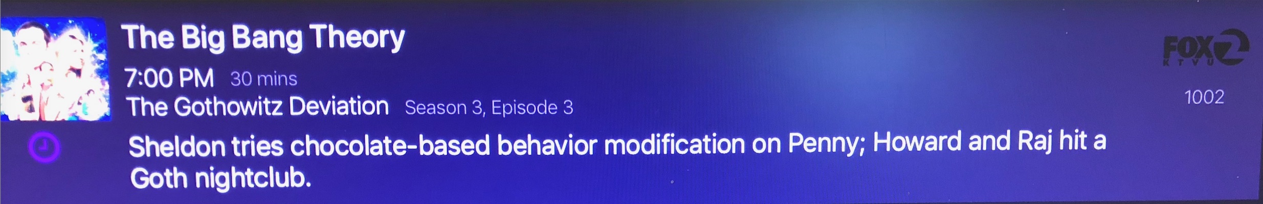

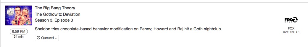

See images below: (1) DVR screenshot of tuner priority (ATV settings also match this). (2) The Big Bang Theory is available on channels 1002, 702, and 2.1. 1002 and 702 are cable.

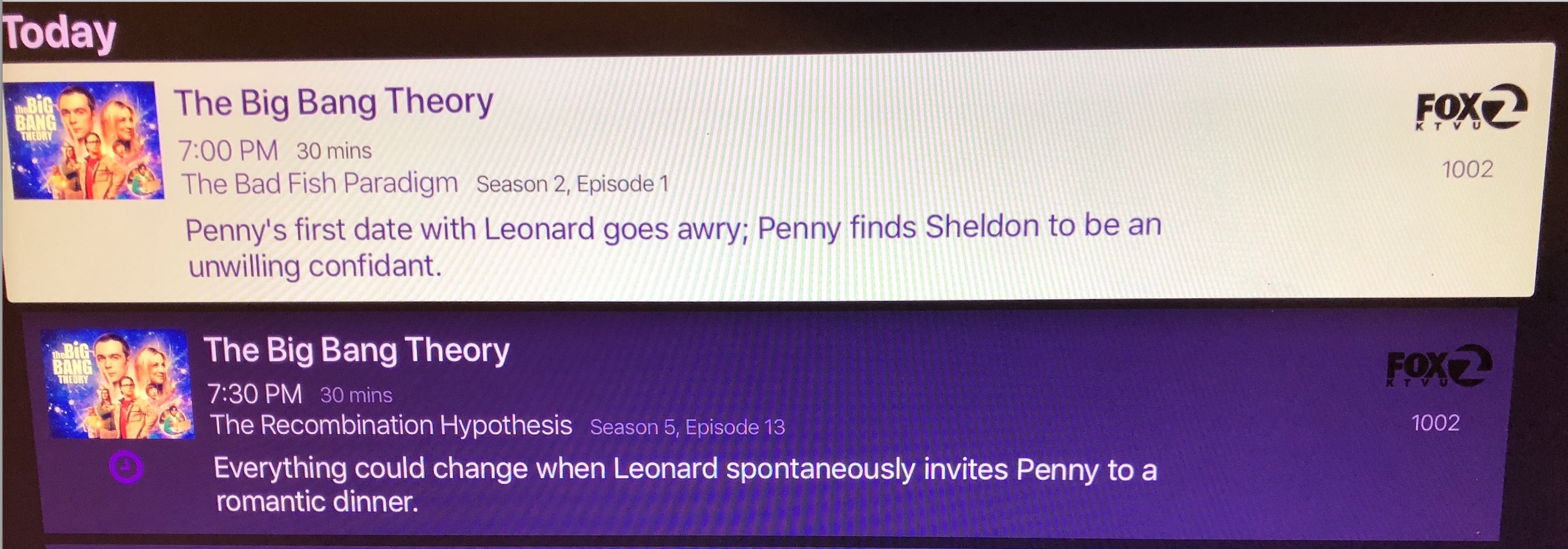

I then opened the ATV Channels app on the ATV and it showed (3) the show is scheduled to record on channel 1002.

The list of channels shown is all the possible channels to try. When recording time comes, it should go through the tuners in order and try them.

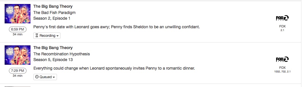

Appox 17 hours later, checking both my Macbook Pro DVR's Schedule section and also my ATV DVR schedule, it looks like the change did not work, BUT checking the log and my Prime tuner, it appears to have been successful. See log below. Also, at 7:05pm, the Prime tuner did not show any LEDs, hence no active cable tuners.
NOTE that the ATV display is in error - the program was not recording on channel 1002, but rather 2.1 (see log). I rebooted my ATV before taking that screenshot to make sure I didn't have residual data floating around in the Channels app on the ATV.
2018/02/05 18:59:00 [DVR] Starting job 1517885940-4 The Big Bang Theory on ch=[1002 702 2.1]
2018/02/05 18:59:00 [DVR] Waiting 29m59.979849107s until next job 1517887740-4 The Big Bang Theory
2018/02/05 18:59:00 [TNR] Opened connection to 1033264E for ch2.1
2018/02/05 18:59:00 [DVR] Recording for job 1517885940-4 from 1033264E ch2.1 into "TV/The Big Bang Theory/The Big Bang Theory S02E01 2008-09-22 The Bad Fish Paradigm 2018-02-05-1859.mpg" for 33m59.979778355s

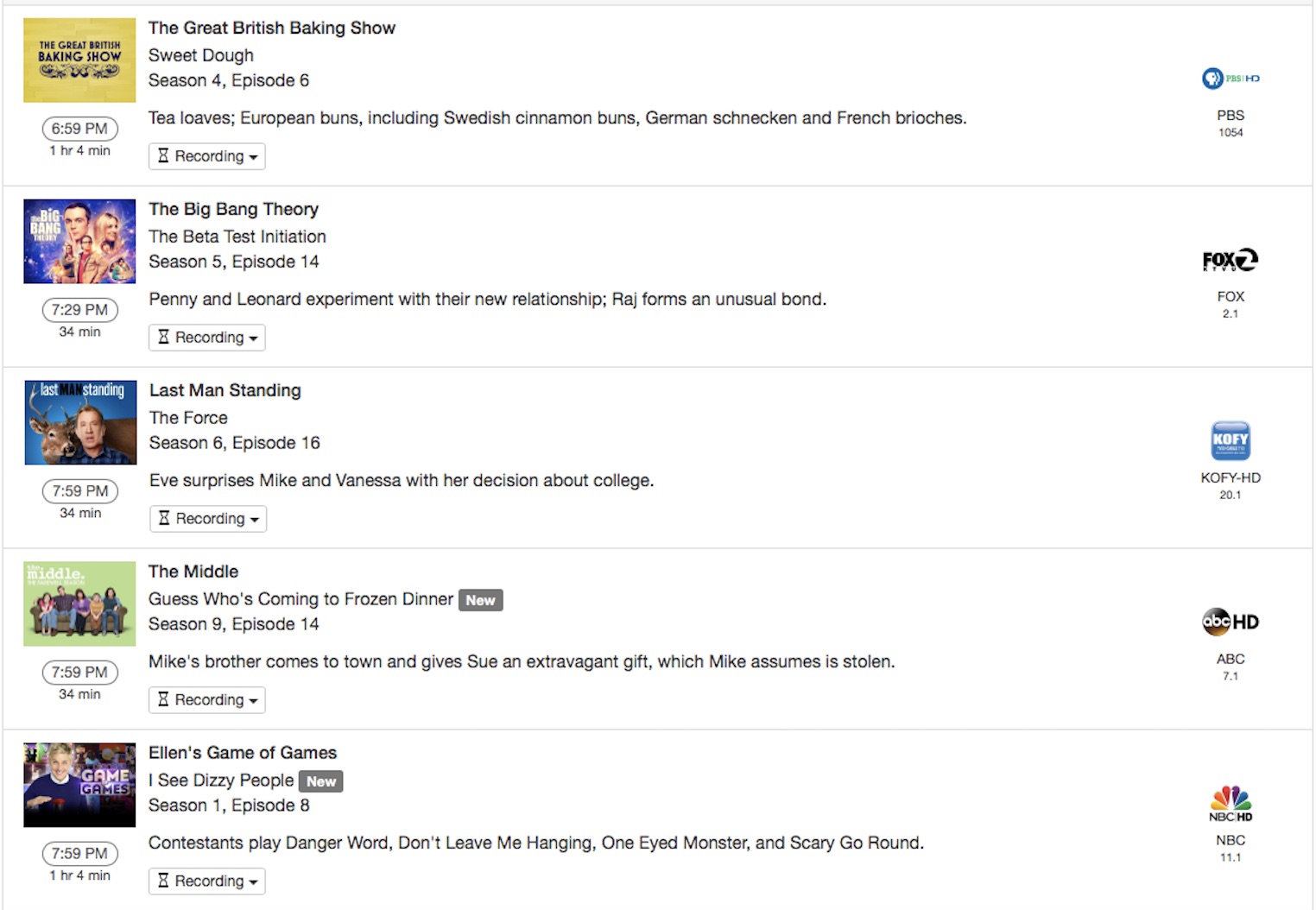

Here is so more log data. There was one OTA tuner in use at the time, so the tuner priority seems correct. I think the British Baking Show was put on cable because the corresponding OTA channels are not marked as HD.
