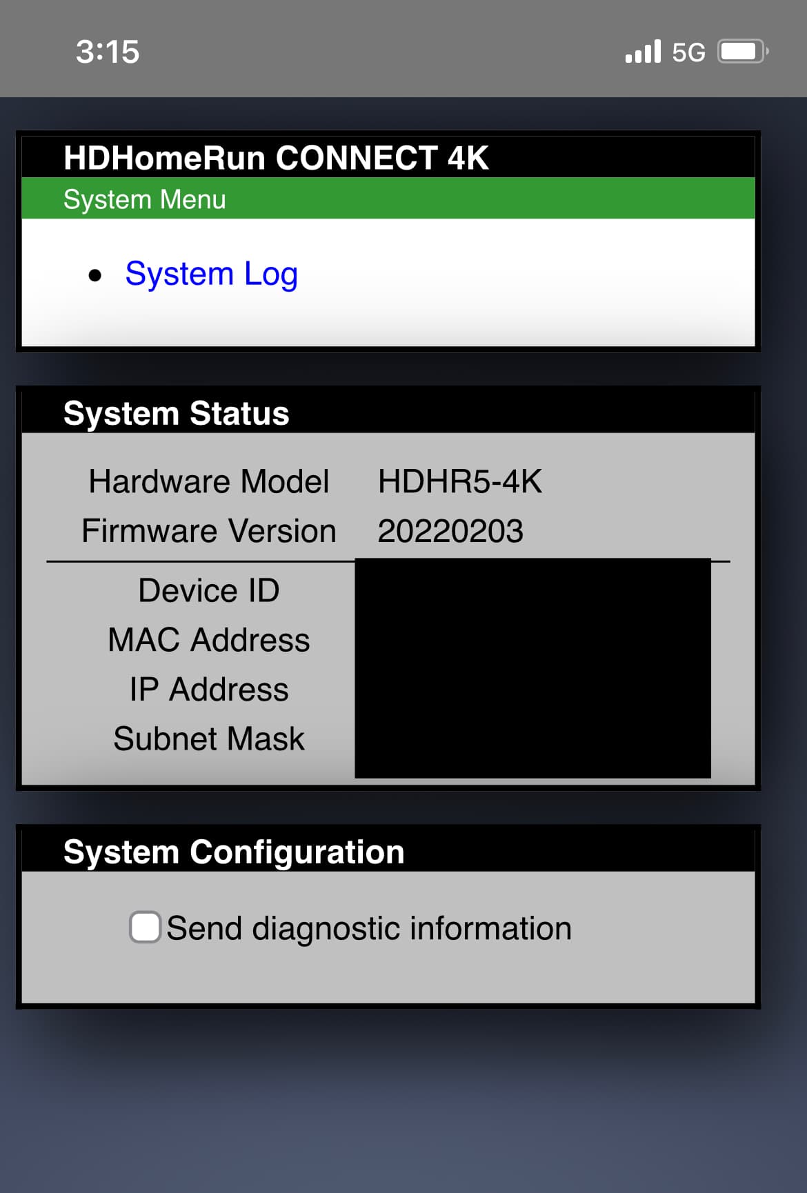

There was a new release of the HDHomeRun firmware that addresses ASTC 3 problems with some channels. I have it installed and have no problems.
Latest firmware is Feb 3rd 2022.
"FirmwareName":"hdhomerun5_atsc3","FirmwareVersion":"20220822","DeviceID":"1080ACCC"

You must have seen the update showing on your HDHR tuner web interface.
If there was an update to 822 they have pulled it or are rolling it out in waves. I don’t have an update available on my kickstarter hdhr4k
I always use the Windows Setup release to update the others are always behind.
Did you have a ticket open or complaints with SD regarding ATSC3? How do you know that ATSC3 problems were addressed with some channels? I have 2 HDHR5-4K and neither is prompting for an update.
