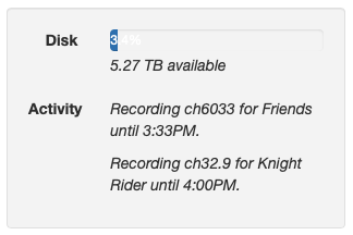

The turner sharing feature does not appear to work. Meaning, if I start a program on one appleTV and then start on an iOS device, the DVR log does not show that the two clients are sharing a connection. They each appear to be taking a tuner.

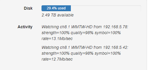

Just for a data point, I set tuner sharing on my AppleTV and then watched the same channel on my Android phone. I don't have an iOS phone.
I just fired-up the same channel on our Apple TV and a Fire TV. Only one tuner in use, as per HDHomeRun Config.
I'm using production releases all around.
I submitted diagnostics from my DVR and event time is between 10AM and 11:30 AM. You will see the are time that two clients do share, but I was running a test with three clients. Two where sharing and the third did not. The two clients where iOS devices and the third was an AppleTV.
Just fired-up another client on my iPad. Still only one tuner in use here.
Here's what I see when AppleTV is running. Tuner sharing is enabled on AppleTV.
Please submit diagnostics from the Apple TV.
