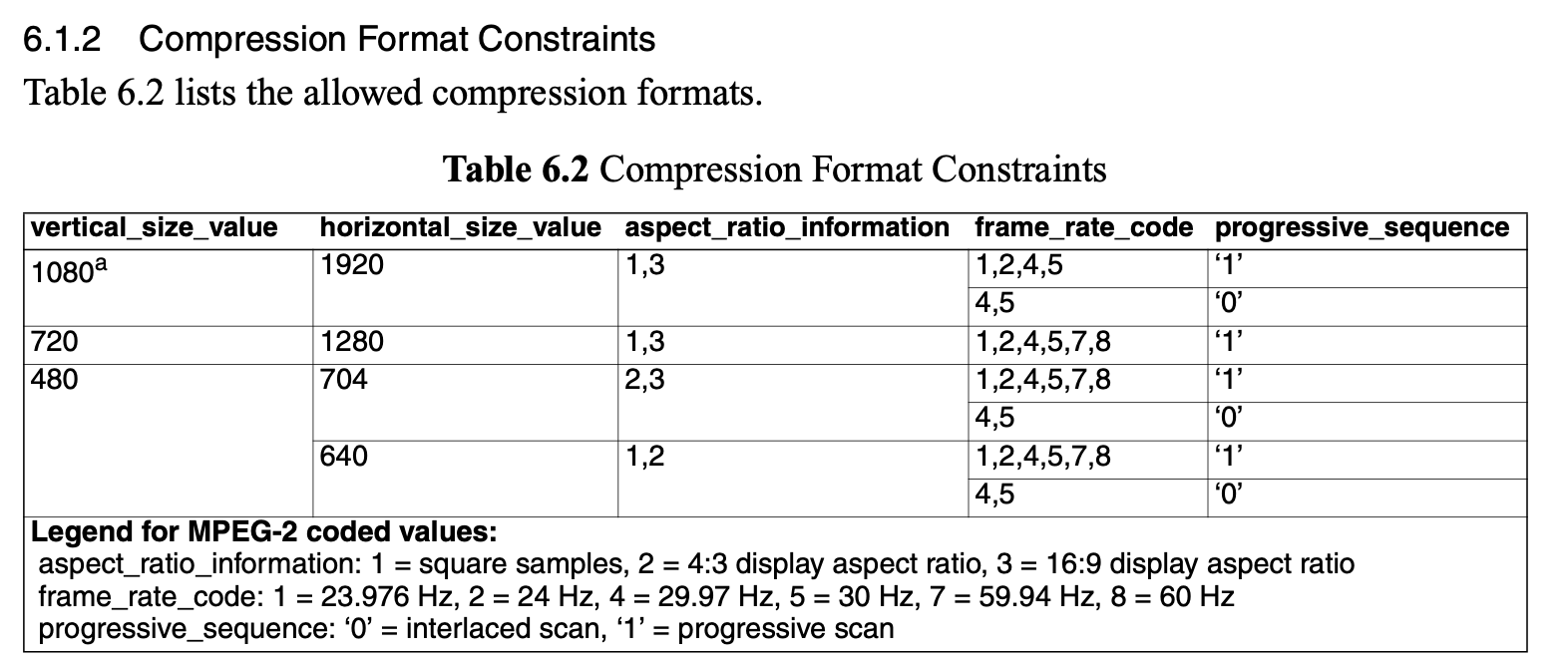

It's allowed:
(See page 9 of https://www.atsc.org/wp-content/uploads/2015/03/a_53-Part-4-2009-1.pdf)
You usually don't see it because we're limited to 30 full frames per second in 1920x1080. So usually broadcasters use 1080i instead which allows them to get 60 fields per second. The only way to get 60fps progressive is to step down to 720p.
Sometimes, broadcast encoders will dynamically switch to progressive scan mode when they detect non-interlaced content. Using this allows them to display 29.970fps or 30fps content in progressive scan. They can also achieve progressive scan for lower frame rates, like 23.976fps or 24fps, by using the REPEAT_FIRST_FIELD flag to instruct the television to display selected frames for longer to achieve a telecine cadence. It's likely that this is what's happening here. This tends to be more common on non-realtime formats like DVD, but it's certainly possible to do with live television content too.
As noted from a post, I stand corrected.
I've never seen it in the wild, but I guess it can happen. Thank you @dbloom for the pointer.
