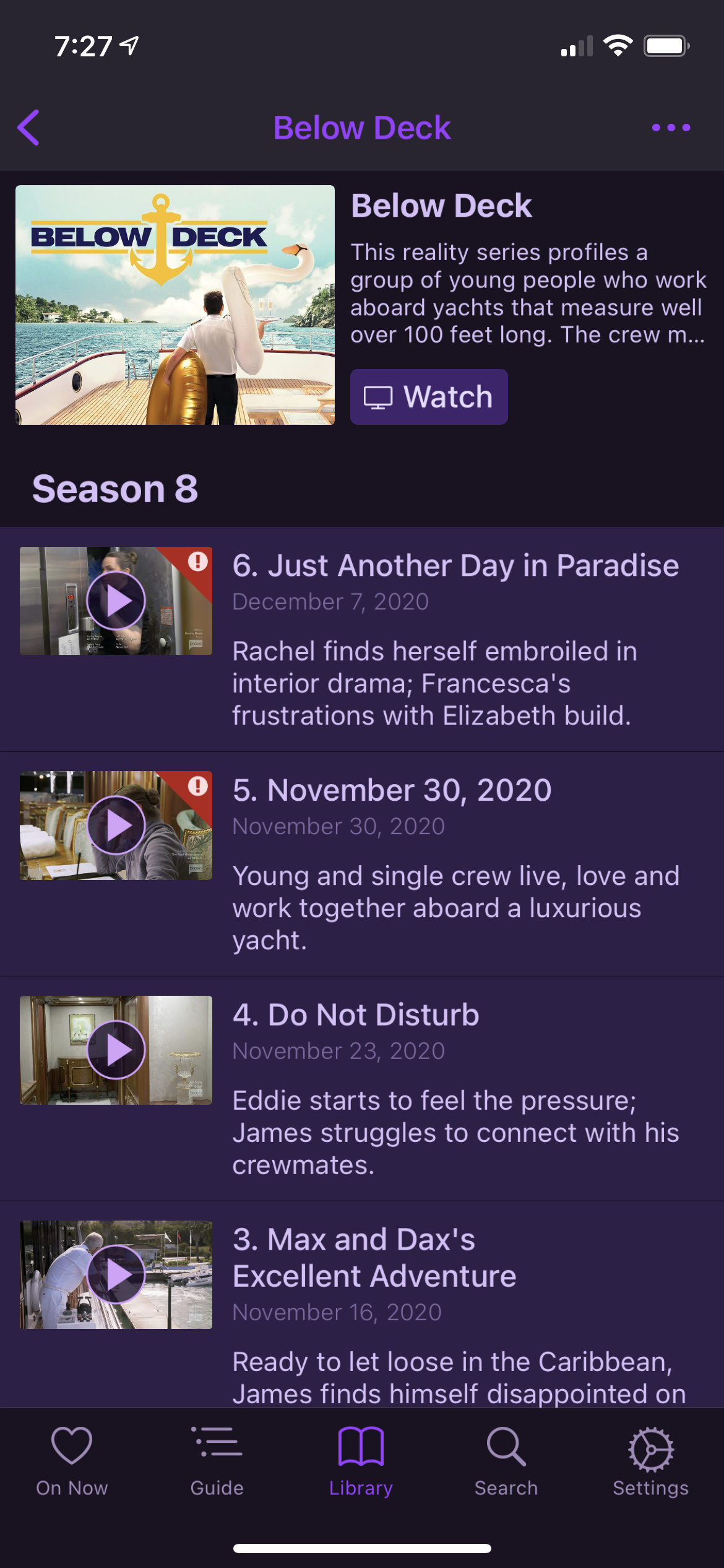

For about the past month, getting consistent recording interrupted errors while recording shows on Bravo. On Channels, it shows the red exclamation point indicating the recording was interrupted at some point during the recording session. Its only with Bravo TVE - other TVE HGTV, CNBC, ESPN, , etc channels record no problem no errors which leads me to think its something upstream. Anyone experiencing this problem with Bravo too? Presuming its something with the stream feed from the URL that Channels TVE uses to pull down.
Here is an example from a recording last night from the log file. It stills recorded, but the playback will be impacted and skips several minutes here and there inside the show as it looks like TVE loses the feed.

It's been especially bad the past couple of days. It's not just Bravo, but all NBCUniversal TVE channels.
Same thing here. We notice it on Bravo and E.
We also have Bravo recordings that play but then skip around (both forward and backwards) and the recording end abruptly. Sometimes only 10 minutes of an episode is recorded.
Seems to have gotten really bad lately but been going on for at least a month. We’ve had to resort to watching Bravo shows on the NBC app since the channels recordings don’t work anymore.

It happens on Below Deck, most real housewives (Potomac and Salt Lake City this week). On E the show is Total Bellas.

Sure enough most of my recordings we just deleted the other day. I do have 2 recent examples on Below Deck (matches what itdmekb mentioned too). Its sporadic, but happening more often than not these days. The 12/7 recording of Below Deck I grabbed some entries from the log in original post, doesnt show much though, just that it was cycling through trying to connect which results in gaps not being recorded once it begins this dance. The recording ultimately finishes, but you are missing minutes of show sporadically through the episide.
