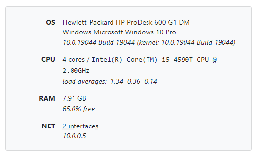

System

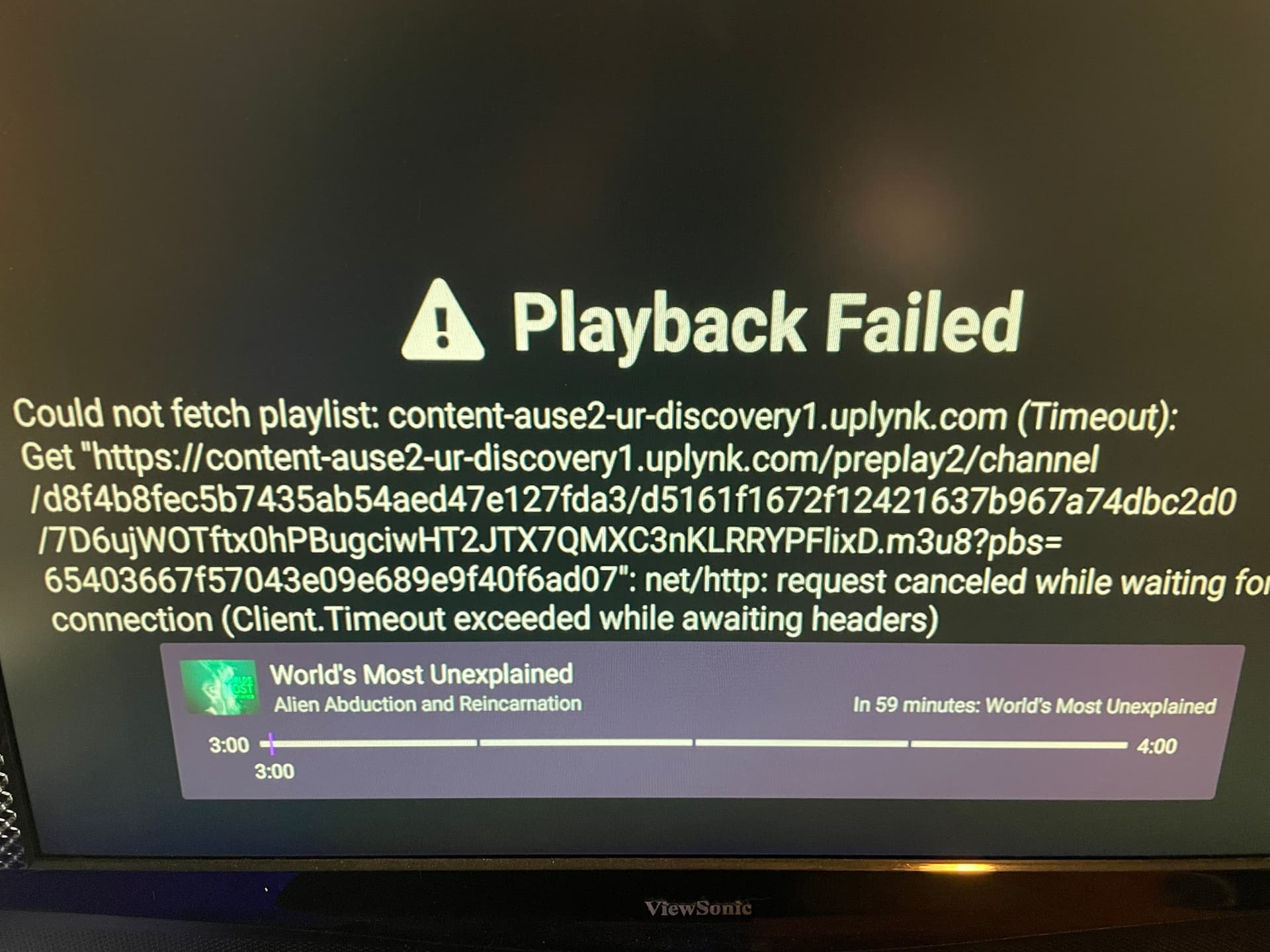

All Discovery related channels are now bombing, is there a log I can send? Honestly at my wits end here. This machine does nothing except to be the DVR, Windows 10, wired ethernet, no other issues with accessing the web.
Does it work again after rebooting the PC?
