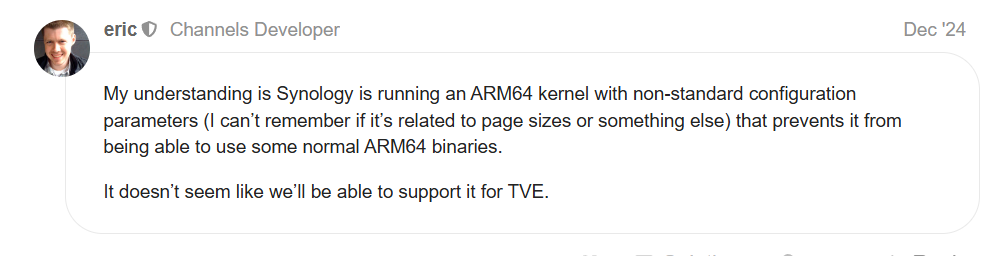

It's been a while, but I recall having a heck of a time with an ARM based synology 2-3 years ago. @eric helped me and it worked for a while, but at some point had the issue again and couldn't get past whatever the issue was. Dug up the message thread he and I had:
