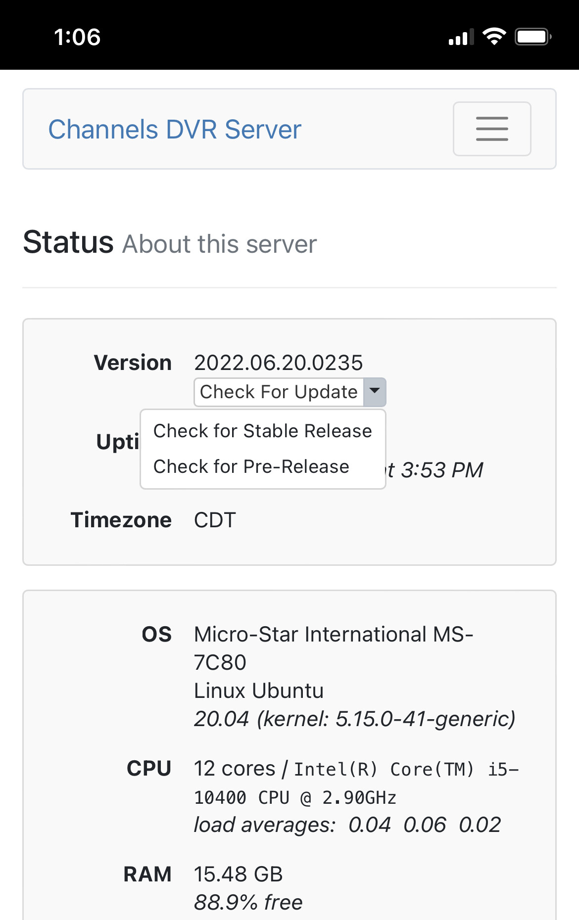

Hi all! My DVR is on 2022.06.20.0235. I am trying to look for a pre-release and it's not showing any which I find odd as this build is a month old. I did submit my logs for review.

There is one showing for my Ubuntu from .0235. But I don’t run in a docker
What displays for you at this url?
https://channels-dvr.s3.amazonaws.com/prerelease.json

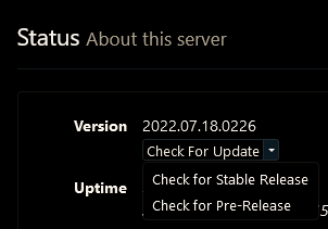

And what happens when you select Check for Pre-Release?
Might want to look at the dvr log after doing the check.
