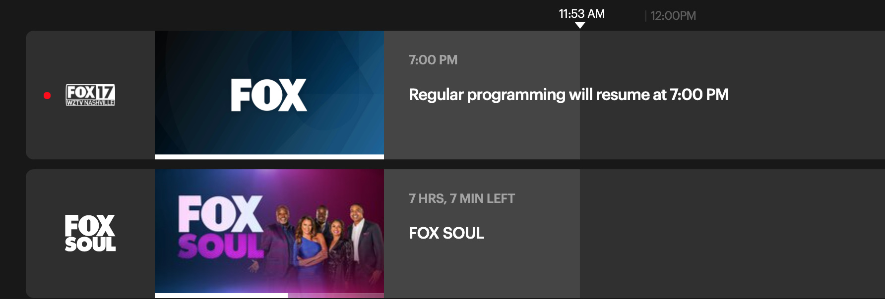

I set up my Channels DVR PreRelease version 2021.06.30.0218 and scanned for channels using Hulu Live TV and I am not getting the local FOX station 6002. I am getting CBS, ABC, NBC, and PBS but no FOX. I also tried using my DirecTV account and FOX does not appear as well. I went to fox.com/live and was able to login and see content. .
I just sent the logs off: 6a3513ac-b2e6-4f11-a119-60f019eaeaba
Screenshot what you see on fox.com/live
Based on the message, it appears they are not brodcasting right now? Should I scan for the channel tonight to see if I can get it?
Only streams which are available 24/7 on fox.com/live are compatible with our TVE feature.
That's to bad. I guess the only way to get the local FOX station through Channels is to sign up for Locast?
Sure, or a hdhomerun and antenna
This appears to be based on Fox-affiliated vs Fox Owned and Operated stations. The Fox O&O stations appear to be the ones that come up 24/7
