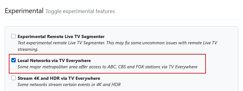

The next time you're physically closer to the Boston station or notice your browser giving you the station you want on CBS website, try toggling "Local Networks via TV Everywhere" in the web admin interface off and on again. Make sure you allow geolocation. That will allow Channels to pull the correct station from CBS.

I updated to to 2025.11.26.2338 I then toggled the Local Networks via TV Everywhere to off, refreshed my web browser. Then toggled it on and then scanned all channels multiple times.I tried doing that using chrome and Firefox from 2 different computers and i still get the ABC station from Saint Paul, Minnesota.
