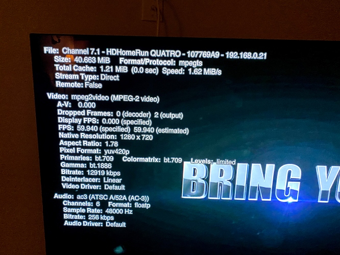

Did you use the stats function to see if it shows dropped frames?
Three screenshots attached. One is TVE recorded show playback, one is OTA recorded show playback, one is live TV playback.
No dropped frames on any of them. The TVE recording is the only one that stutters.

I had read about V14.5 also having this capability so I decided to try out the 14.5 beta. It’s very close to release so I felt comfortable trying. The above screen shots were made with the 14.5 beta. The FPS on the TVE shows 29.97 for both specified and estimated vs. 29.97 & 59.94 on the two others. Super happy to know that Aman will be looking into this. Thanks for your update.
